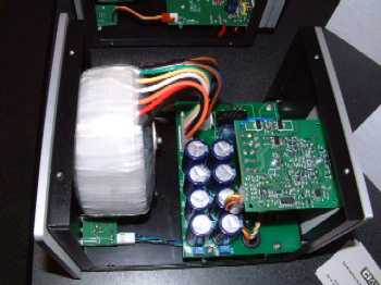

I like the PS of Stef very much. It looks much more professional than mine, although having a very similar schematic, i believe at least. And his setup is much nicer too.
As another example you might be interested to have look at my setup:
More pictures, especially showing the "modular" supplies, are here:.
And yes, I "forgot" the caps across the MBR10100 in this version too. The supply is completely quiet. The simplest way is the best in this case.
Jan-Peter and Bruno,
is this not an idea for the next supply module generation? I would buy them, if they would include a full bridge per cap/rail and use Schottkies instead of a normal SIP module. I need 8 modules for my active speaker setup (in progress) including dipole subwoofer. The type of mounting directly to the UcDs is "sexy". 😉
The reason for using one full bridge per rail is to be seen here:
Best regards, Timo
