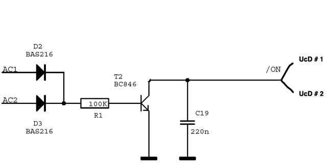

A question about the anti-ploc circuit from Jan-Peter.
Can I use one circuit to connect two or more UcD180 modules?

stef1777 said:A question about the anti-ploc circuit from Jan-Peter.
No problem. The on/off pin is only interested in yes/no, so it's not sensitive to noise.

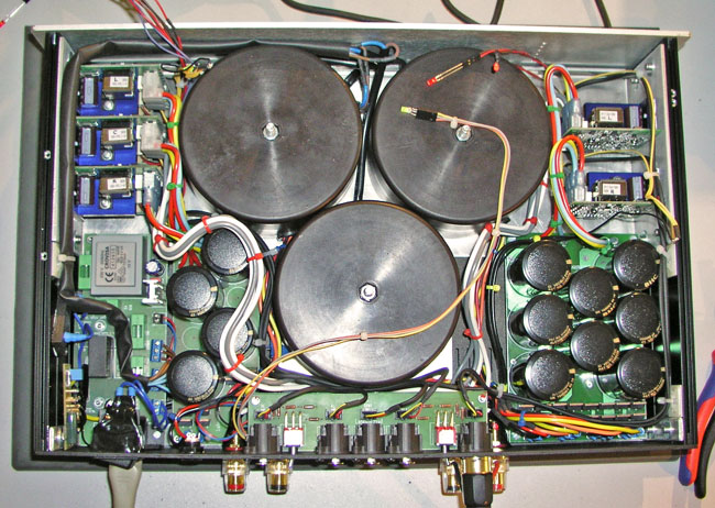

New in my desk, a 5 channels UcD180.
5 x UcD180
2134 op-amps and BG NX-HiQ caps
3 PSU (one for 3 channels, one for each front channels)

Amazing that you can squeeze that all in that case. Would you do it again or would you use a bigger case if you knew before hand that it would be so tight?

I'll definitively use the same small box. I was looking to build something very small. The challenge was there.
