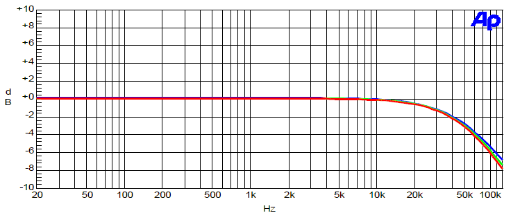

Re: Maximum load R?
The somewhat curious result of this is that when you run the amplifier without load and watch the pwm duty cycle while doing a frequency sweep, the modulation effectively drops to near zero at the resonance frequency, precisely because the filter is undamped and produces voltage gain. At the same time, the output of the filter will be a nice constant voltage.
The UcD data sheet (which admittedly is not always easy to track down on JP's web site) shows a graph of frequency response at loads of 3ohm, 6ohm and No Load At All. The physical resonance frequency of the filter is 35kHz. As you can see, the UcD control circuit simply takes the filter's own frequency response out of the equation.
No other commercially available class D amp does this. Other amplifiers either
1. ignore the problem, making feeble attempts to mollycoddle it by setting the corner frequency very high.
2. same as 1. but add a zobel network
3. have some of the feedback from the output filter, reducing but not eliminating the problem. Normally a zobel network is added to such designs to insure stability under no-load conditions.
This effect is absent on UcD. The feedback takes off at the output. Even at the resonant frequency, the output voltage is fully controlled (Zout=0.1ohm at 35kHz).DSP_Geek said:UcDs have a 2nd order lowpass filter at the output, series L and parallel C to the load. A no-load condition means we're essentially dealing with a series LC circuit, which with an applied signal near the resonant frequency tends to build up higher voltages on the components.
