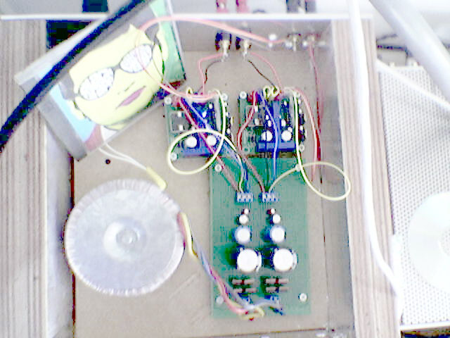

withoud trying to flood this thread (i'll back off ) here a not-so good pic of the amp, with a cd case for sizing comparison. It's a temporary case, threw the clone i wasn't happy with anyway out, put in the amp. pic made with my phone, when i get my final enclosure i'll post another (hq?) pic.

Matjans,
I have made you picture a little bit lighter
Small suggestion; turn the modules 90degrees, so that the T are right and left. And put all wires of the powersupply in the centre of the modules and make them some shorter.
