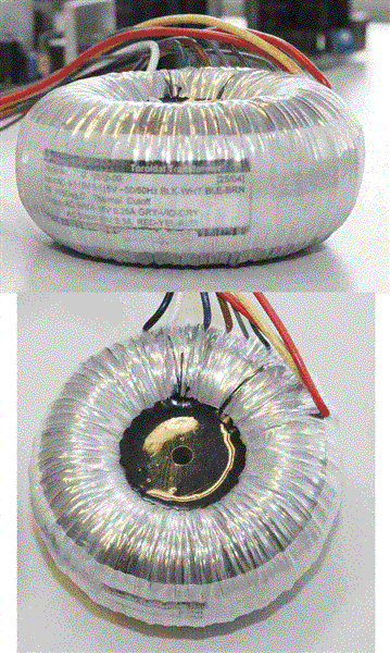

Special custom made on our request. The weight is lower as with a traditional transformer and becuase the wires are winded on a cirkel you need less length of wires (decrease copperresistance) and have much less mechanical noise......
Jan-Peter
www.hypex.nl
Jan-Peter
www.hypex.nl
Torema here in Sweden made toroids with rounded corners and they had only plastic film as insulation towards the core.Jan-Peter said:Peranders,
I'll think the swedish Torema is no more....
