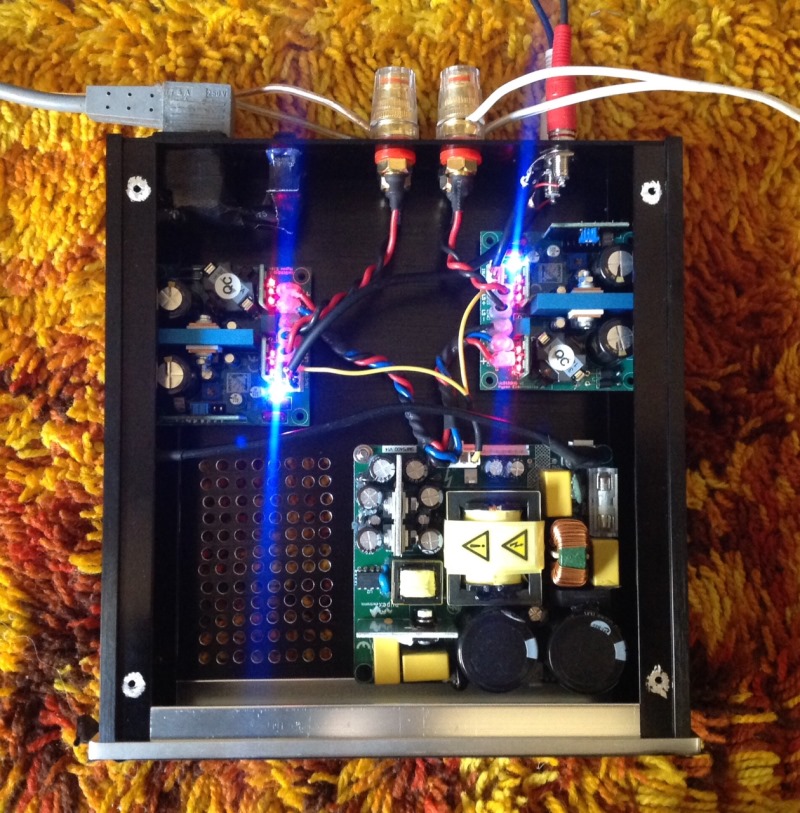

Finished my Ucd180st amplifier but I have some hum/buzzing in one channel. Should I connect XLR pin 1 to chassis? Or is there something that seems wrong in my setup.
Hypex recommends balanced input wiring (XLR) and connecting the ground (pin1 ) to chassis:
http://www.hypex.nl/docs/appnotes/wiring.pdf
However, I'm using unbalanced (RCA) and their recommendation is the same, connecting ground to chassis with the exception of disconnecting mains earth (and using double insulated wiring):
http://www.hypex.nl/docs/appnotes/earth_appnote.pdf
Now this looks ok for monoblock kind of applications. However, I have four UcD amps in the same box with single PSU (using toroidal transformer) I can't get rid of all of the buzz. Bruno mentioned "pseudo-differential" RCA input wiring in the latter application note but doesn't go further. Has anybody used anything like that? I assume you need to separate the RCA ground from chassis in that kind of wiring. My first attempt on this box was something like it but it didn't work properly (amp was quiet only when nothing was connected).

I have set up a stereo pair of UcDs in an unbalanced connection without any issues. The only difference or rather addition was a double-gang pot to act as a volume control between the RCA jacks on the chassis and the UcD inputs.
If you have XLR inputs on your amp enclosure, make up some RCA to XLR connections, linking pin 1 (ground) and pin 3 (cold leg) together at the RCA end. Ensure the XLR is wired with the three (2 + screen) wires at the XLR end.
It's also worth reading up the notes and papers about the infamous pin1 / ground loop issues on Rane's website: http://www.rane.com/pdf/ranenotes/Pin_1_Revisited.pdf
Also (taken from the NCore400 notes), here's how it looks:

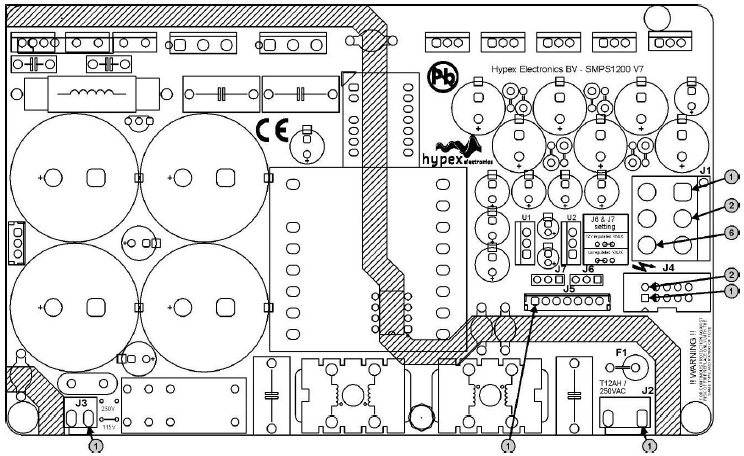

I have 4 UcD180 modules on bi-amped servo controlled speakers and I am looking to move the electronics from a single enclosure to separate mono enclosures at the speakers. I am using a linear PS in the combined chassis and would like to move to SMPS in the mono enclosures. But I need +/- 15vdc also for the servo circuit.
Does anyone know of an SMPS that will supply the +/- 50VDC for the UcD180's AND the +/- 15VDC for aux gear? After looking at Hypex's site I don't think their unit does so.
Thanks in advance,
Hi Troy,
Yes, the SMPS provides two sets of voltages: +/- 46, 73, 85V for the main UcD180/400/700 units AND a second +/- voltage rail.
It's either regulated at 12V or unregulated around 21~22V by a pair of jumper settings on the SMPS.
I'm using the unregulated version which I'm then pushing through a pair of L7815 and 7915 voltage regulators to give me +/- 15V rails 🙂
edit:
On the SMPS, J4 provides either unreg 21V or reg 12V rails on pins 1 and 2 depending on jumper settings.
However, J5 claims to provide unreg voltage on pins 3 and 7. I'd have to check, but I think this is regardless of J6 and J7 jumper settings.
