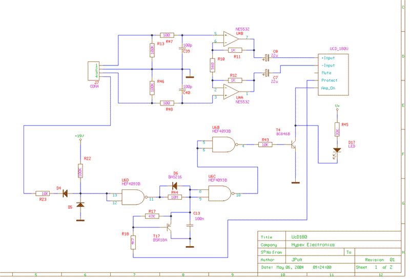

Is this schematic for the UCD180 still the same appart from the input impedance?
There will be small sockets on the output to allow for coupling caps or shorting links dending on the type of op-amp
I'll use offboard regs to power them up, with these I can adjust the voltage from 12 - 15v
The imput impedance is 100K on that one. I know it was said it was wrong at the time it was posted, but at that time the module actually had 10K. 🙂
It's more right than not.
Might I suggest for a direct A/B to include the AD8620 on your board?

I'm not sure if any of the above would cause problems like oscillation etc in this circuit so if anybody has any advice it would be appreciated
Regarding the input inpedance should I fit 10k or 100k?
