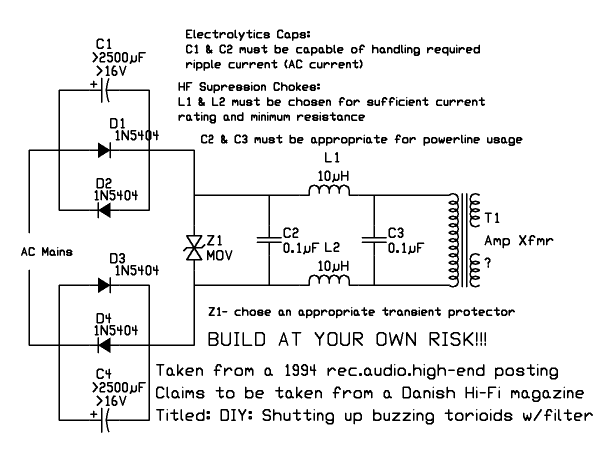

No thats not a DC filter, when you say DC filter did you mean this
King Kong:bawling:

Oh, about that DC filter, I'd do away with the MOV and use a TVS, MOV's degrade with each use.

classd4sure said:
Yes, I meant that exactly.
Or half that, even. In my case grounds are dirty and connect to neutral at the panel so I'd probably try the whole thing and blast not putting any circuitry in the neutral line, just build a good level of redundancy into it.

"I'll try the DC filter later, my transformers are dead silent, no buz etc which according to from what I've read means I don't have a DC problem with the torroidals but I'll try it anyway"
Cool! You likely do have some DC on your line, having no buzz just means you've a good transformer or it's not high enough to affect it in an obvious manner. My transformer doesn't buz either but DC is rather high. It's got mu metal wrapping and an epoxy filled center. I've little doubt removing the DC would improve the sound though, looking forward to your results.
