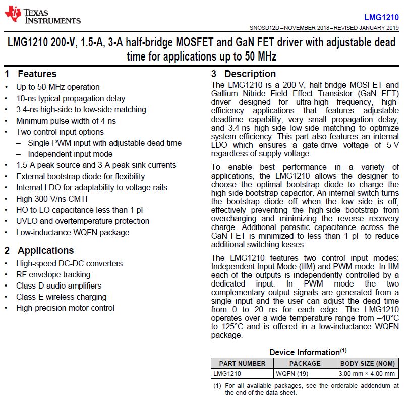

Irs20957 bad driver for gan , need use drivers with a little delay. Si8231 as in purufi, lmg1210, etc.

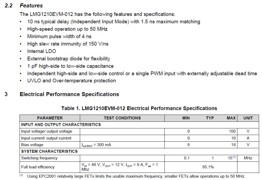

The TI evaluation board allows one to experiment with a little more layout safety margin on the GaN drive.

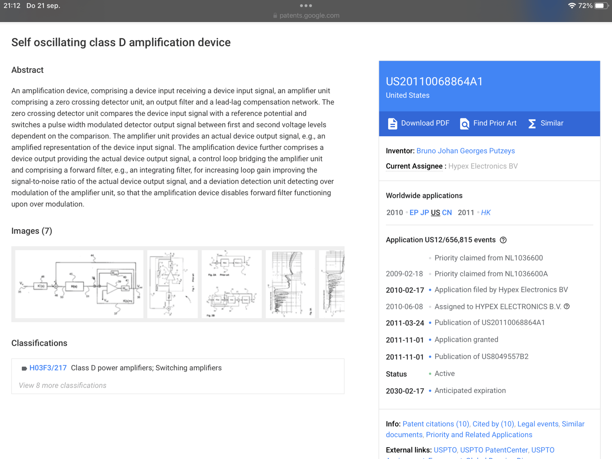

Why not use the now expired bash patent... and avoid all the unnecessary and highly distorting parts/aspects of standard class D design? I don't get it....
Little bump here.
By now these patents are fully expired, so open for anyone to be used.
I am actually kinda surprised that not a lot of people/companies jumped in?

Many have already delved into the uniqueness of these patents on commercial scale (hush, hush). After spending years exploring the details and asking pertinent questions, some features of these patents are notably reproducible.
Key Features of the Patents:
- Microcontrol control monitoring. (innovation lies in the firmware)
- Anti-windup Integrator clipping. (PID theory)
- OC trips utilizing the first point (MCU monitoring).
- Differential second-order integrator (basic analog skills).
- Undisputed THD (Total Harmonic Distortion) figures, which rely on Esoteric Math Modeling. This remains a challenging area for DIY enthusiasts
Bruno Putzey is the master in this? 5th order compensator. maybe reading the work from Christophe Basso may help using Transfer function. FACTs method?
- Dynamic Control theory.
- Control theory during failure modes.
- Control theory during clipping.
- Control theory during amplifier recovery.
- Elaboration on feedback paths, explained using Resistors and Capacitors.
