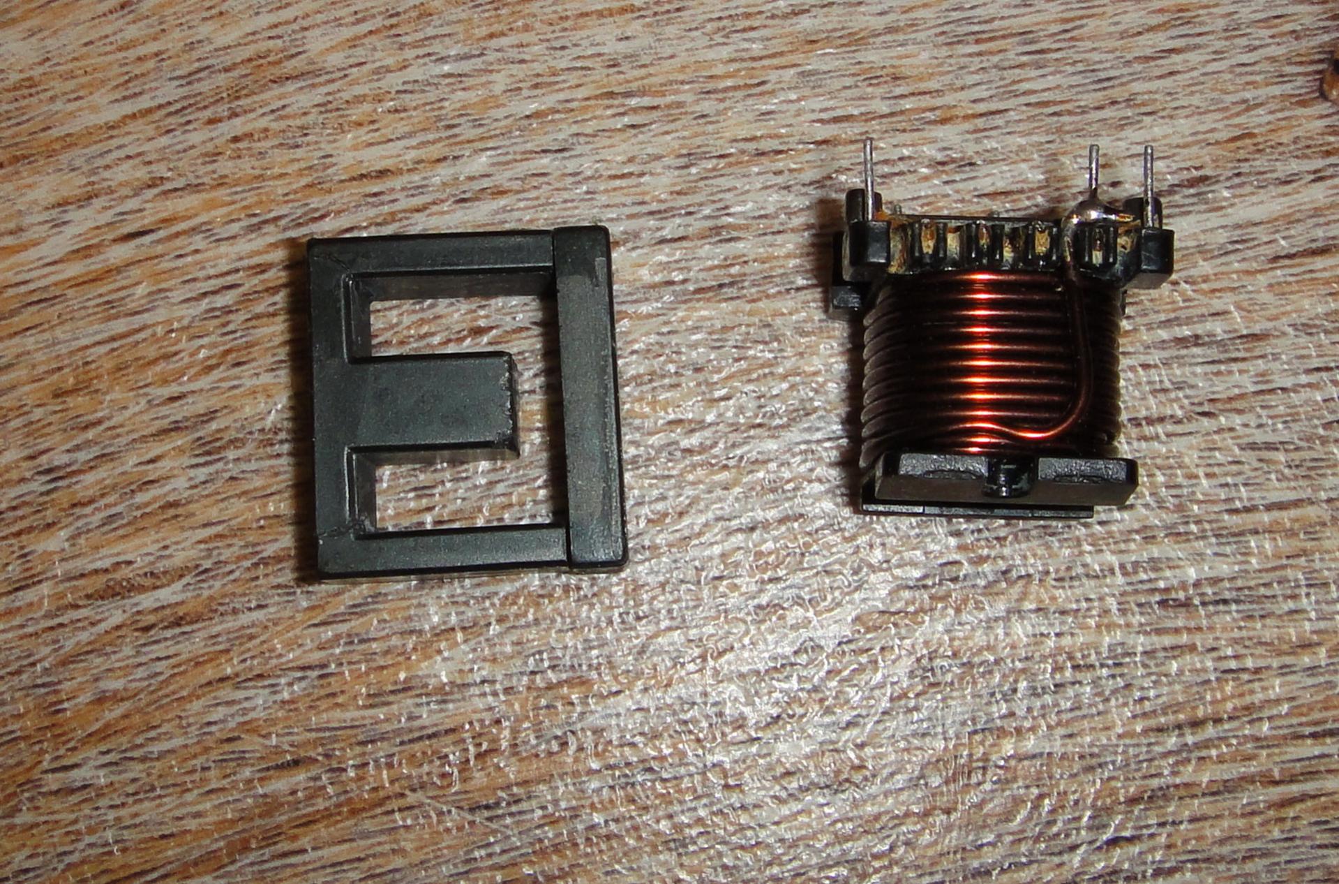

try to get e cores from old pc power supply and boil them in hot water . after separating them coil 30 turns and make sure you add 1mm gap using a tiny piece of old cd or dvd disc. .
A good thing , but the gap must be larger - something about 2mm , or 4mm in the center leg.😉
why large gap like 4mm😕😕
If you want 1000 W, then fsw should not exceed 200 kHz. Then L>40 uH is advisable to achieve low idle loss. Since 100V/3 ohm (current headroom needed!) = 33A, E>22 mJ. Energy density in gap at saturation is about 40 mJ/cm^3, so at least a half cm^3 is needed for this much power. A=1.2...1.5 cm^2, so d=4 mm is a good estimation. But leakage is horror! I use 4 mm also, but in EE55 (A=3.5cm^2, L=80 uH), so it's safe and perfectly cool.why large gap like 4mm😕😕
But for only 50 V and 4 ohm, 1 mm gap is OK!
