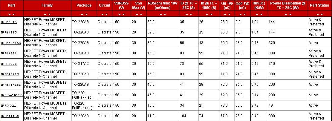

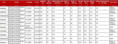

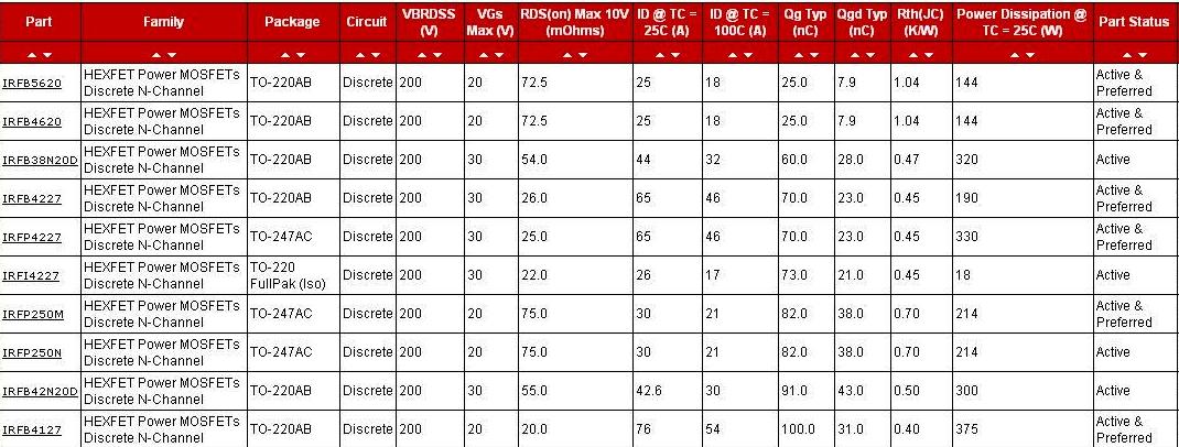

MOSFET RECOMENDATIONS
Hello
greetings can any one advice me which is most suitable mosfet for this amp
i am using IRF250 on50 volt dc rails
1 IRFB4103Pbf
2 IRFB 4227BPbf
data sheet of IRFB4103 shows Rds on@10 volts 139Mohm
data sheet of IRFB4227 shows Rds on@10 volts 19.7Mohm
can anyone advice me most suitable mosfet
warm regards
andrew lebon

Catch🙂
It's for rail up to +-65V
The "lightest" , I.e. prefered from the top.

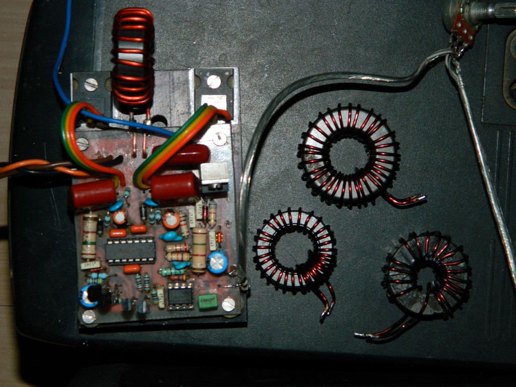

FINALLY WORKING
Hi
greetings can anyone guide me as its only my second sucessful d class amp
at last managed to make amp work outputs are IRF250N my supply is 50 volts
dc amp is sounding clear and powerful in 4 ohms load only problem is my output inductor after testing about 20 different cores finally managed to get cores which are luke warm on high volume testing on trying different cores of same
material with more and less turns sound quality changes more treble another core more bass how do i know which is best output inductor for me i cant get
t106_2 core here so i cant really tell what core will sound best can any one suggest where i can order t106_2 prewound 33uh inductor

There is something wrong in your application. This is not an ordinary ClassAB amp. Therefore you must not use wires from PCB to output mosfets. First correct this and mount the mosfets directly to PCB and then try your different output inductors again. There should be some difference. It is very difficult to say which inductor is best without any measured result.

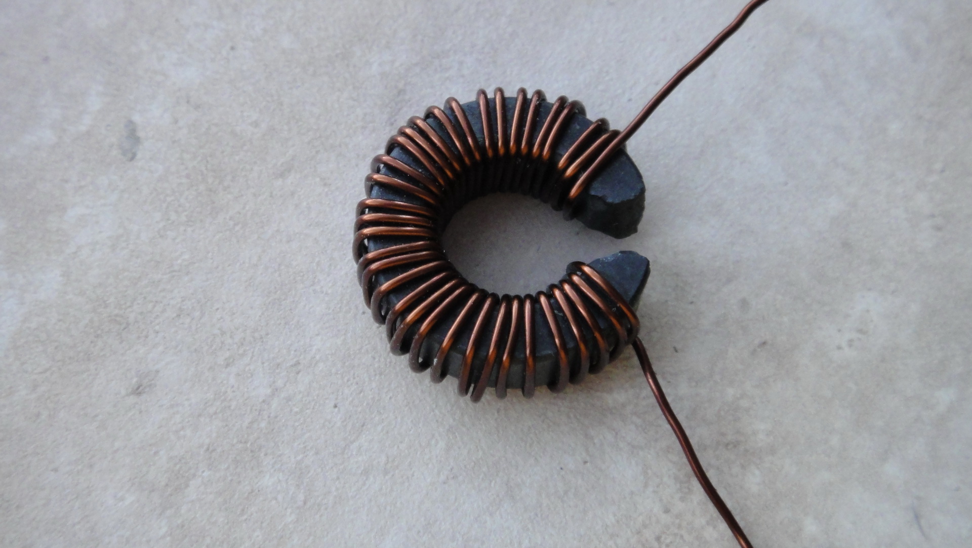

The cores that i see at your foto seem to be ferrite?
It's not good to make inductors on ungapped ferrite😉.
You can make a gap in a Ring-core with a grinder , some thing about ~3mm . So it woudn't saturate.
Like this

congrats andrew finaly you have it working. try to get e cores from old pc power supply and boil them in hot water . after separating them coil 30 turns and make sure you add 1mm gap using a tiny piece of old cd or dvd disc. BTW cool car stereo sony gt490 🙂🙂😎
