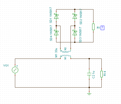

Here is how i plan putting current transformer.
You mean pin 2 is starting, 4 is ending, and 3 is center tap? Theoretically it should work (as long as oscillation goes), but inserting inductance (only leakage, but still...) directly into drain is not a good thing. If you can keep it below 20 nH, then try it!

The CT was made 1:1 over output coil.[primary and secondary have same number of turns in my case it was 40 turns]
I limited the dutycycle to 10 to 90% in order to make sure i never run out of pulses while switching at 250khz and then averaged the output of CT using full bridge rectifier made from schottky and limiting was applied with optocoupler and SCR latch based on different time constants.
Workhorse: Using your method: otuput coil as current transformer would be the easiest method. But I cannot simulate it, and if i calculate it manually using the transformer model, it seems like not working.
Pafi: as my calculations a T37 with 1-1 turns would not saturate. (at 50A B=0,03T) This would mean 4nH (2mOhm impedance at 250 kHz, 16nH end-to-end), and this is shunted with the transformed secunder load (2 mOhm). This connection only needs one core, and it could even detect cross-conduction (it has double sensitivity for that).

I still don't understand. A normal current transformator have to be in series with the main reactance. In an amplifier the choke is the main reactance at fsw. How could it be in series with itself?
I tried to draw what you seem to said, but it can't be correct. On R1 the whole power supply voltage arises. Please tell me what did you really built!
During normal mode the voltage is much less than power supply rail especially when the modulation is happening, only in case of short circuit it builds up more voltage and give you indication. One more thing there is capacitor + Resistor based HP in series with secondary in order to get the HF switching ripple measurement only and LF is not sensed that way.
How would this possible in this circuit?!? On the primer there is a square with Vdd amplitude! Why wouldn't it be on secunder?!? You've missed something very important!
Square is on secondary, no doubt but not with VDD amplitude when audio current is flowing through speaker or load.

This is not a real answer. You are trying to make us fools. No schematic, no working principle, you gave nothing. Why wouldn't it be Vdd? And how this could help in sensing current?
Maybe it's got something with non-linearity or other things we neglected in our transformer modell. But so far I have no clue how or why it would work.

Leakage inductance in this case plays a vital role and this scheme works best in short circuit only not for linear monitoring of current. But the thing is that it works like a threshold detector. The voltage rises very quickly up to certain level >>VDD during applied short circuit which enables us to have an indicator for that condition.

I don't have time to try this, especially since it is undefined. If leakage has a basic role, then you should define where exactly the secondary have to be wound. And the rest of the circuit is still missing. What could I try?
Short circuit? It doesn't mean current is flowing. Where is the threshold, and what defines it? Saturation? (What else could?) Then this must be based on the theory I've mentioned before, in #821, increased di/dt during saturation.
Anyhow, this is not a current transformer.

I can give you some pointers , wind the secondary on one side of inductor with thin wire but same number of turns to maintain same ratio, don't spread the winding. Yes the working is based on leakage inductance + saturation of core, no doubt on that.
