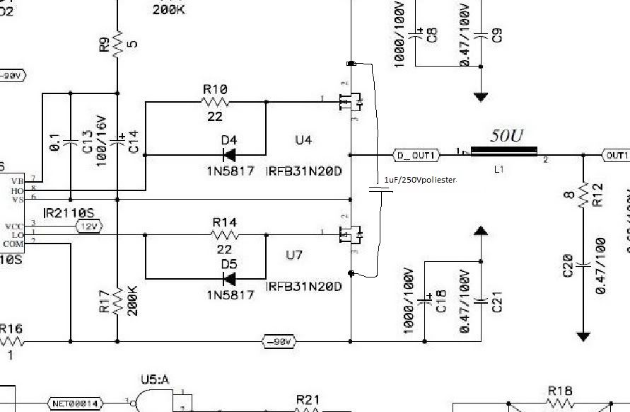

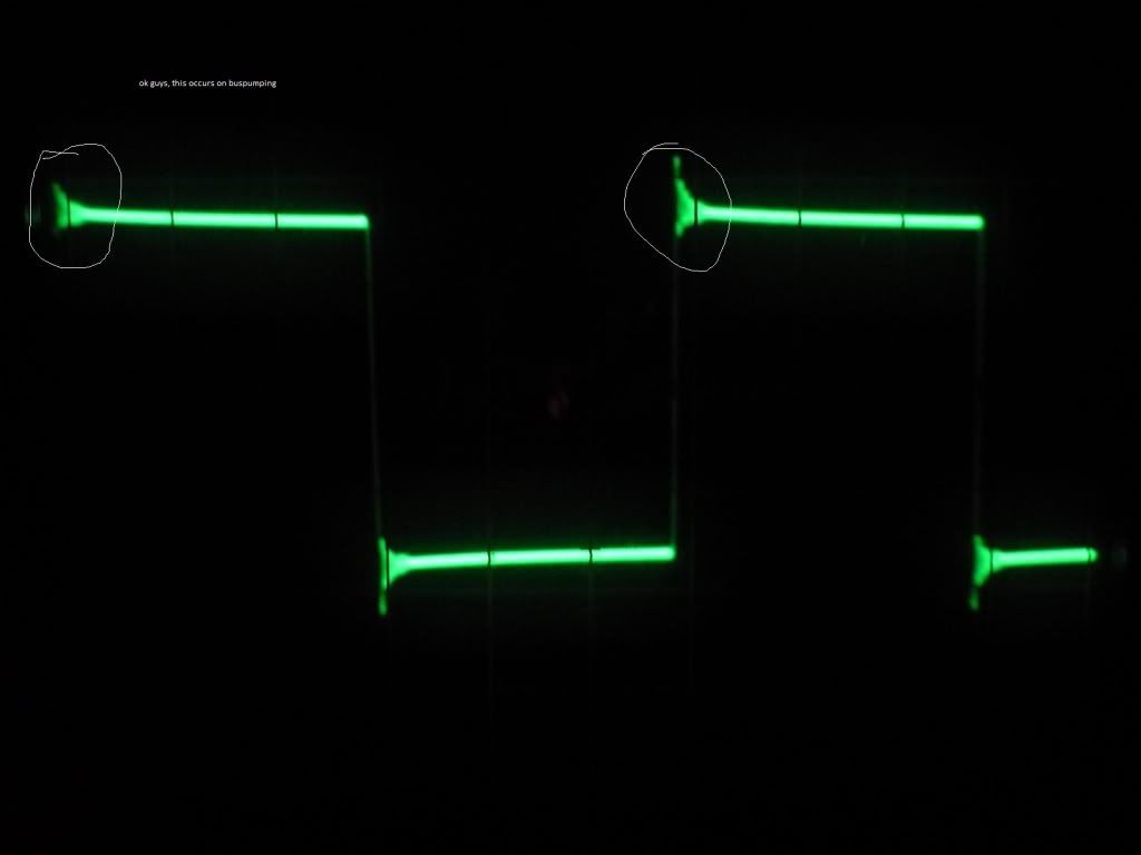

hello guys,a good yet very simple solution for buspumping is to add a 1uF/250V poliester capacitor like this "see the pictures"

hello guys,a good yet very simple solution for "buspumping" more like Pafi said (overshoot/ringing) is to add a 1uF/250V poliester capacitor like this "see the pictures"
Thank You Pafi
