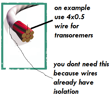

Your design is improving very much, now you can easily realise efficiency of class-D. Gapped ferrites are better than iron powder cores (less wire, less losses). You can even improve you inductor by using multiple thin wires (4x0,5) instead of one thick.

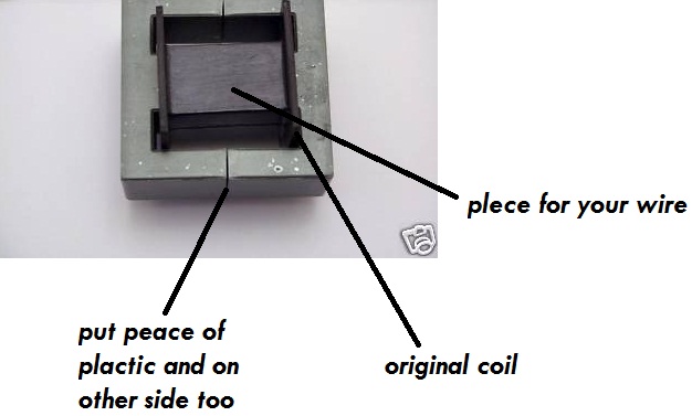

If you cant find iron core or some ferrite core (tiroid), you can use ETD34 ferrite core. If you cant find etd, you can use ferrite core from pc power supplay. That core is EE33. Simple you remove core from pcb of power supplay, put him in water and cook it 🙂. When water start to boiling, cook it 5 minutes, and while is worm you parted core on two peaces. Remove wire from coil, and use 4 wire 0.5mm and make "one" wire. 16 turns of that wire will be enough. When put together two peaces of ee core, use two small peaces of plastic from CD case (1mm), and put beetwen core, then you have gap on your core. Glue the core and this is your good output coil.Likely to work well up to 600W.
One think, when you wind up your coil, wires must not go over the gap, because will be warm.
Let someone correct if I am wrong about everything
Use wire for transformers. No, you not wind diretctly on ferrit core. Use original coil, but remove old wire and yelow tape. When is coil free and empty, start tu wind your wire. You can use a wire of 1,2 mm or 1,5 mm but is defecult to winding and better is multiple wires.
