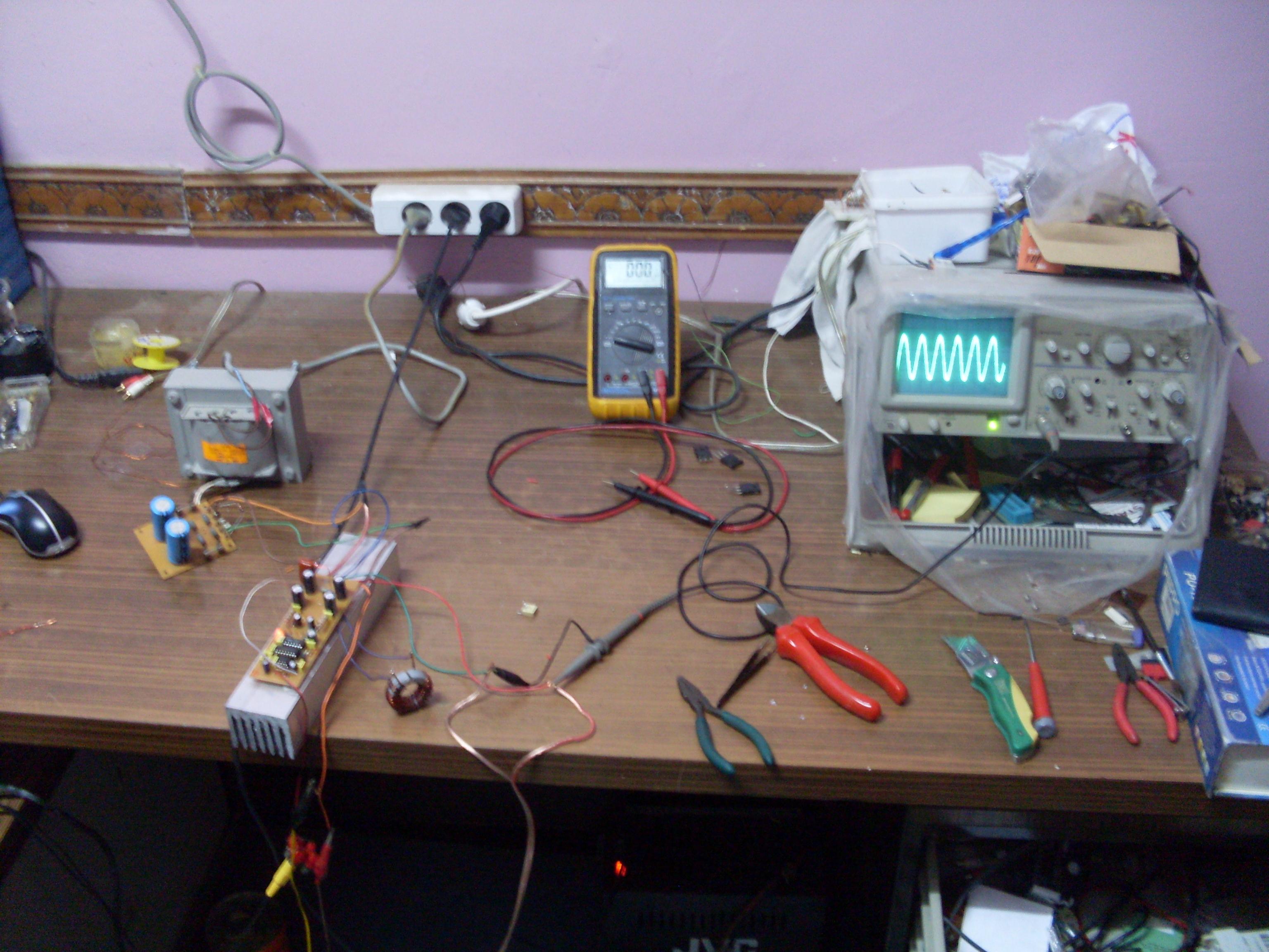

Hi all,
I have try T150-60 from Micrometal and EI33 from my PC but core are still very hot. It seem that we are facing the same problem.
Hi all,
Material -60 is not a good choice, you must use cores with much less permeability, like material -2 or material -6. Are you sure its an EI33 core? Isn't it EE33? How much air gap did you used? What are the wire resistances of you inductors? How much is the switching freq? How much very hot is?(approx in degrees, for me very hot is the boiling vacuu-oil in the lap, i can easily get out things from boiling water)
With the original switching freq of 140kHz and 50kHz low pass, almost any core will be hot, just calculate it... if there is no sufficient air gap, or bad core material, it will saturate...
You can calculate the induction in the core with the following:
B=mű0*műrel*n*Imax/(l_core+műrel*l_gap) (where mű is the greek letter for permeabilities, mű0 for vacuu, and műrel for core, n is the turns, Imax is the current, l_core is the path lengt in the core, l_gap is the length of gap ) put everything in in SI, so you will get it in Tesla. It should be lower than 0,3T.
Then calculate the copper losses in the resistance fo the inductor (best is to simulate).
If you dont do any calculation and design, just try everything without mind, how do you think you will have the luck to make a good amp?
The more turns the less heat. Why? 100uH is colder than 30uH??
Its more complicated than you say.
1. More turn on the same corn gives higher induction (from currents) in the core, so it will increase core losses, and it can even saturate. (you must see datasheet, but B<0,3T is a good start)
2. But bigger inductance gives better filtering (decreases corner frequency), so decreases ripple current, so if the resistance is the same, it will have less copper losses
3. But more turns with the same wire thickness gives more resistance, so more copper losses.
4. more turn decreases induction from voltage ripple on the core.
You must calculate all the losses, because you should minimise the sum of them, usually this involves finding which is significant. . Usualy the increase in the one gives decrease in the other...
1. More turn on the same corn gives higher induction (from currents) in the core, so it will increase core losses...
Laci!
Core loss is caused by fast induction change, not just induction, and higher inductance means lower induction change (at switching freq, which is the relevant).
You can continue: with same thickness the resistance increasas with N, but inductance increases with N^2, so ripple current copper loss will be less (1/N^3), but the same wire may doesn't fit, must choose A2=A1/N, so this loss will be 1/N^2.
Yes, there are two contradictional form of losses, but they are the switching freq. and audio freq. losses. It's simply because at fsw there is a constant voltage, and at audio freq the current is constant (I mean not dependant of inductance).
Back to opor's question:
Basically yes, at idle. Because (dB/dt)^2 is proportional to core loss. But at full load always take care of saturation! Higher RDC can increase audio freq loss, but this is generally insignificant because of high crest factor of audio signal.
I found increasing the switching frequency reduced the core temperature.
I also found adding extra capacitance lowered it a bit too.
I can only guess that this moved the switching frequency further away from the LC resonant frequency at which the LC is a short circuit.
Moving the switching frequency from 140KHz to 220KHz reduced the core temperature by 40 degrees C.
The resonant frequency of my LC was 40KHz.
1. Pafi, you are right! I knew Ploss~dB, but I knew it wrong then.
2. 3. Hmm. I thought it would be N/N^2*N, so I was surprised, but I calculated it and really, Ploss~1/N^2. But corner freq moves 🙂 - so it would be same to recalculate output LC to a lower corner freq.
But its more complicated than just "more turns less heat". The last few cores noted here are surely saturated! And you even should calculate idle losses, and load conditions. For me idle temp should be lower than +10°C to ambient, and even a normal clipping (the 6dB crest factor) should be max +50°C to ambient
nigel... at 140kHz of switching freq everybody should lower CORNER FREQ (not resonant freq, if real resonant freq from the parasitic capactiances of the inductor would be 40kHz that would be bloody hell) of filter. For a 140 kHz switching freq the LC corner freq should be lower, which means larger inductors and capacitors... byebye tiny full range class-d amp.
I did increase switching freq over 200kHz, like nigel, so more filtering. If you mean you increase LC filter capacitance you move corner freq too.
