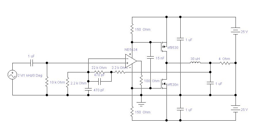

I am still curious, does this schematic the only shared by Pafi really work?
Does NE5534 can drive IRF530/IRF9530?

please can you explain "why ,amplifier has carrier frequncy only 230khz,cannot preform as fullrange amplifier.
230khz not enough to slice audio input and reproduce back to be a good sonic quality. It will sound like a compressed sampling in digital sound.

for Mhz switching there are not fast enough mosfets for and if excists she have much to high gate capacitance who has to be driven properly.
I think 800 Khz is nice, and far away from the audio, making even a 50 Khz wide amp.
You right, but not neccesary.
A very good Hi Fi class D amp can be with only 400kHz pwm.
In this case, UcD much better from clarity because of better feedback and sound profile similar to class AB.
