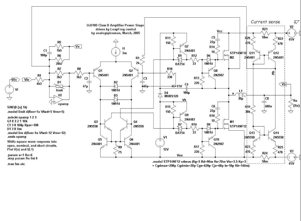

picture is one from @analogspiceman 2005, so a long time ago it is a hysteric window type amp. also from the Phillips datasheet.
But this is now 1200 watts, there is a need of a cery fast power stage with very high fall and risetimes to get low EMI and efficienty.

Do you Iraudamp1?
Please learn English! This sentence has no meaning.
And as usual this is only one of the many mistakes you made. Iraudamp uses IR2011S, not IR2110
http://www.irf.com/technical-info/refdesigns/iraudamp1.pdf
And its input is not a comparator made of LTP like yours, but a 2nd order integrator made of OPA. It's loop gain is independent from input source, not like in your! Its offset current is negligible, not like in yours. An other difference is that you can not change its input, it must be inverting. So basically it is totally incomparable to your schematic. Nothing is in common regarding input.
I dont know your problem
Invert or not is a choice. Pro con always there. But you cannit say that is wrong.
Please don't lie! I never wrote it was wrong! I wrote the other way would be better. Do you really think you have the right prohibiting improvement advices???
Anyway show your real working amp please 😀
Not just always blaming other but no real working amp
Do you really think photos made of amplifiers can change rules of electronics???

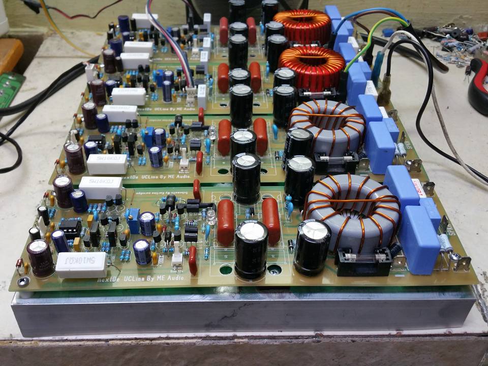

This is my 150V 30A amp inside, during assembling (3 versions were developed, this was the first):
This is my simple UcD version:
This is a bridged amp based on TL494:
This is a 230V/12V 30A SMPS built inside the case of a drill battery:
800 W PSU + 2*400W fullrange amp:
This is my smaller, 1 kW complete sub amp (PSU, amp, preamp, LPF):
And this is the bigger one:
2 kW at 2 ohms, full bridge, 3 level PWM, post-filter feedback, overcurrent measuring on Rds-on (tested with 7 pcs of 18" Eminence Omega woofer in parallel, +/-63V PSU, stayed cold):
This is a very high speed UCD (a little tuning was made on PCB):
These are only the pictures already uploaded here, since I'm not home, I can show only this much, but I've built about 50 ClassD amps. All of them were designed entirely by me, I never copy schematics.

The delay of power comparator section. It is written in the article linked by Kees. Read it before stating nonsense. This is very simple and essential knowledge regarding self-oscillating amps. Without it you can not understand how to design them correctly.
The amp I did refere to was a big amp, this power comparator is also be on diyaudio some time ago, I do not understand what is now fast enough, the bigger the mosfet the bigger the gate capacitance you need a beefy driver to get high up and fall times.
I don't understand what you don't understand. ("now fast enough"? who said this, and about what?) There are both beefy drivers and low capacitance FETs.
This? Where do you see this was 1200W? Not actual schematics, but principles stays the same. Need high fall and rise time to get "efficienty"? Or "low efficienty"? I don't understand your sentence. High efficiency and low EMI are contradictional requirements in this field. I don't know what are you trying to tell.
So you learn personal attack from people typo? 😀
I am not talking the gate driver type but the concept is the same idea. Whether use op amp or discrete, 2nd order or not, THE FEEDBACK is the same! LTP, OTA or not the feedback do the same.
You talk different detail, of course they are different, one is voltage mode the other current mode.
This is not typo. The meaning of the sentence was missing completely, not only some letter. And it is not about your person, but about your posts.
IR2110 IS a gate driver, and this was the ONLY information over "IR" to specify which amp you think about. You can't expect to understand if more than 50 % of the info you provide is incorrect.
Totally not. You have no idea how these feedbacks work if you think they do the same. Try making a quantitative analysis! On OPA inverting input there is virtual GND. On LTP inverting input there is the switching freq residual required to maintain oscillation and modulation. Bias currents are also totally differents. Nothing is the same. Even in the audio range there is significant difference.
I guess you mean LTP output is current. This is the difference that absolutely not important. The input of LTP is still voltage controlled, the output is irrelevant in this aspect.
Pafi,
I am not talking the individual Op amp or discrete LTP. You are missunderstand just because you think you too smart. I am talking about whole feedback loop. However you stuck on how it works for Op Amp vs Discrete. 😀
Again, I was had problem typo by missing to put word "know" in the sentence because my smartphone problem.
So then IR2110 is a gate driver
What about IR2011?
