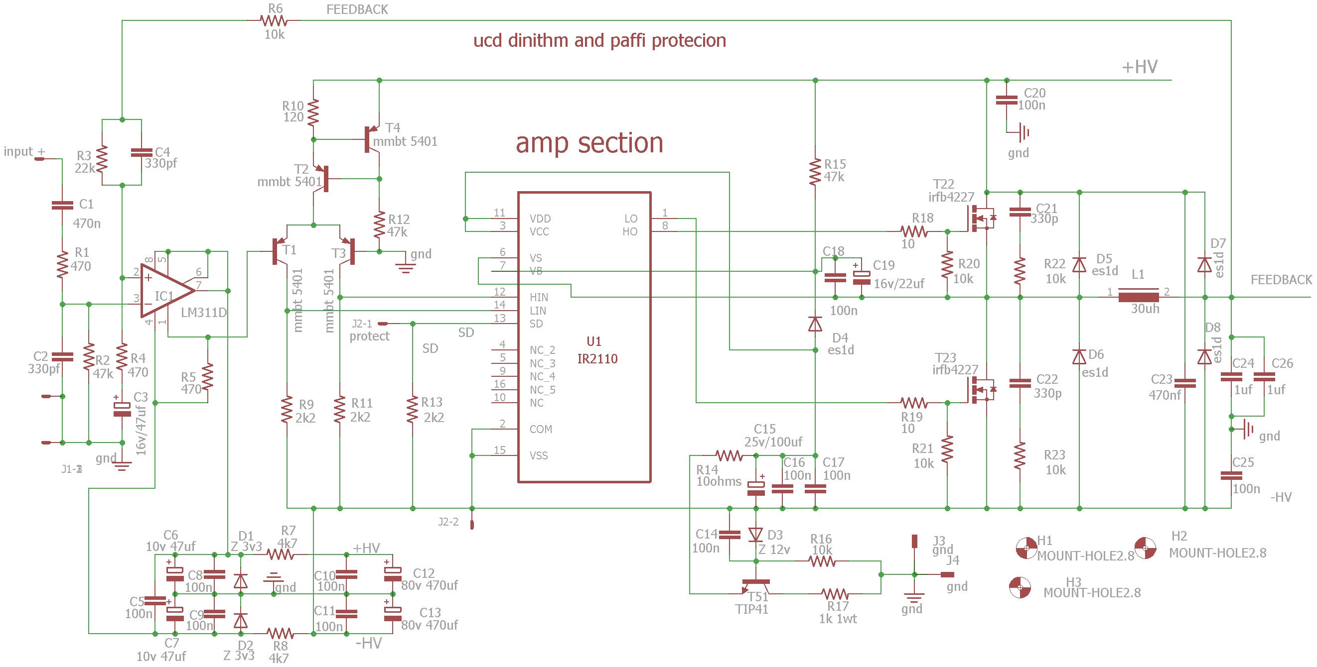

but what a bout "apex d200 " circuit ?
at schematic that is +-75 volts,at the pcb it's +-55 volts!
now can i feed it with +-40 volts/500 watts switching power supply? how many watts that power is?

Stewin:
Why using IRFB4227 MOSFETs with 20mOhm Rdson, when you put 0,1 Ohm resistors in series with them.
The MOSFET driving network is also very ineffective. 47 OHm turn-on resitors can be good for <100kHz. Also BD243 and BD244 is way too slow. Layout is very poor. Some advices:

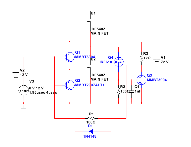

- Use a pair of very fast SOT-23 SMD transistor to boost gate drive (for example MMBT2222A and MMBT2907A is good) rigth next to the MOSFETS. Use a ceramic cap to filter the supply of these SMD BJTs. This will decrease the gate drive length extremely. So less inductance, faster driving, less noise.
- Forget the shunt protecting, it will have more loss than all other parts of the amplifier! Use the FETs for shunt, previousle I posted a simple schematic that does this, here it is again:
As you can see MMBT2907A boosts the turn off, and MMBT3904 the turn off, the first one is smaller.
U1 and U2 are the main FETs. When U2 turns on, the gate signal turns on the Q4 auxiliary FET (the 100 ohm resistor is for this FET should turn on a bit later). The R2 and C1 filters the swithced half bridge signal for spikes. IF the votlage drop at U2 main FET is at least 0,6V (about 20-30A per IRFB4227) it turns on Q3. The output signal from its collector then can be fed to an 555 timer to turn on protection.
The aux FET should have a very small Qgate and Coss, Rdson does not matter.
- Snubber desing is also very bad. RC snubber should be as close to the FETs as possible (1 RC snubebr per FET), because in reality it is an RLC snubber, if L is too big, it will help nothing, it will only make thing worse.

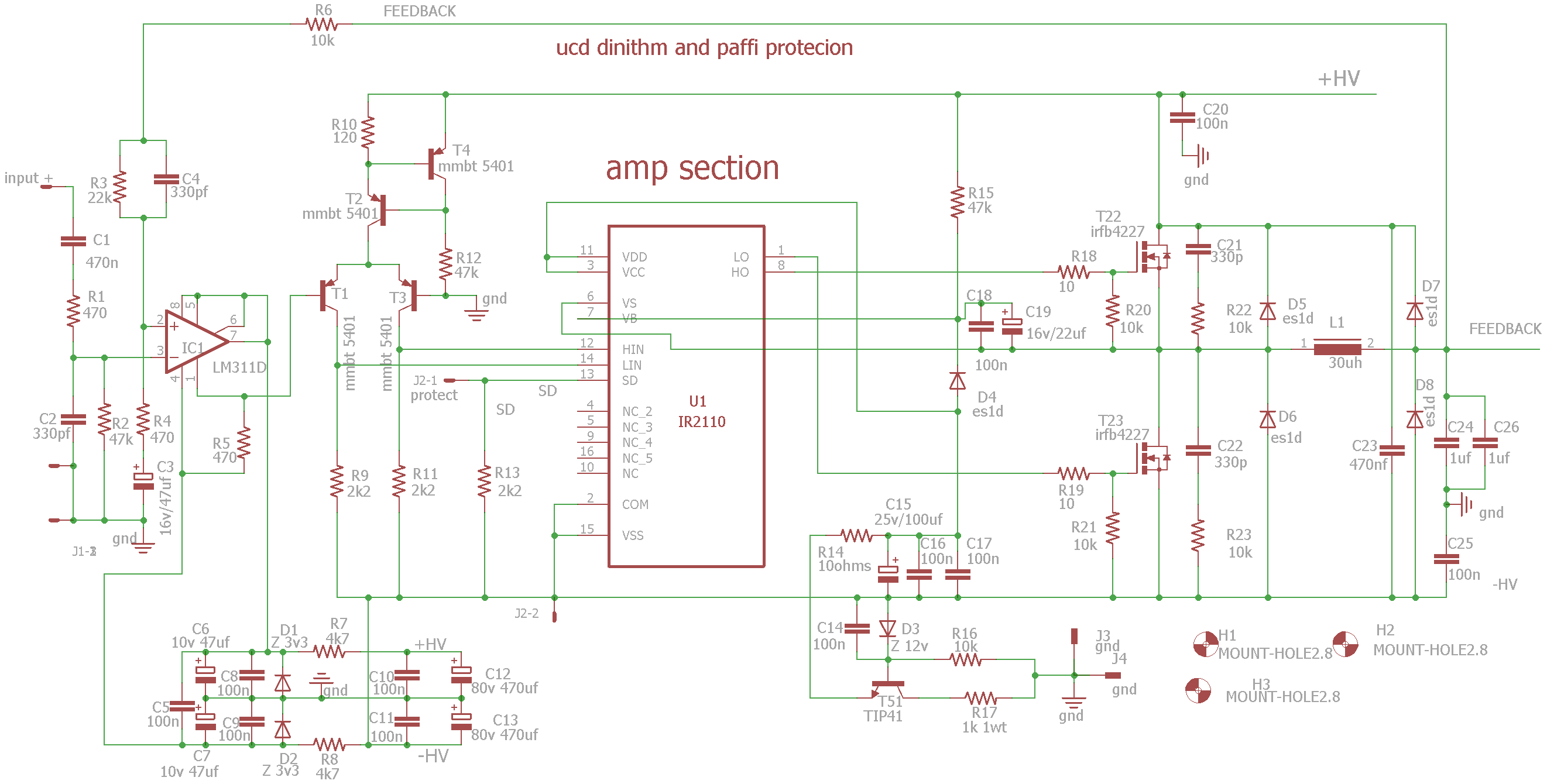

😕hi all does anyone know how to impliment this protection circuit . while using ir2110 and irfb4227 in ucd configuration 😕
problem is (RDs on IRfb4227 = 20mili ohm) ocp current 35A
(RDS on irf540z= 77mohms)ocp current 9A
pls post protect schematic which will work with +/-85volts 1pair of irfb4227 with 2ohms load ir2110 .
the class d i like using is ucd

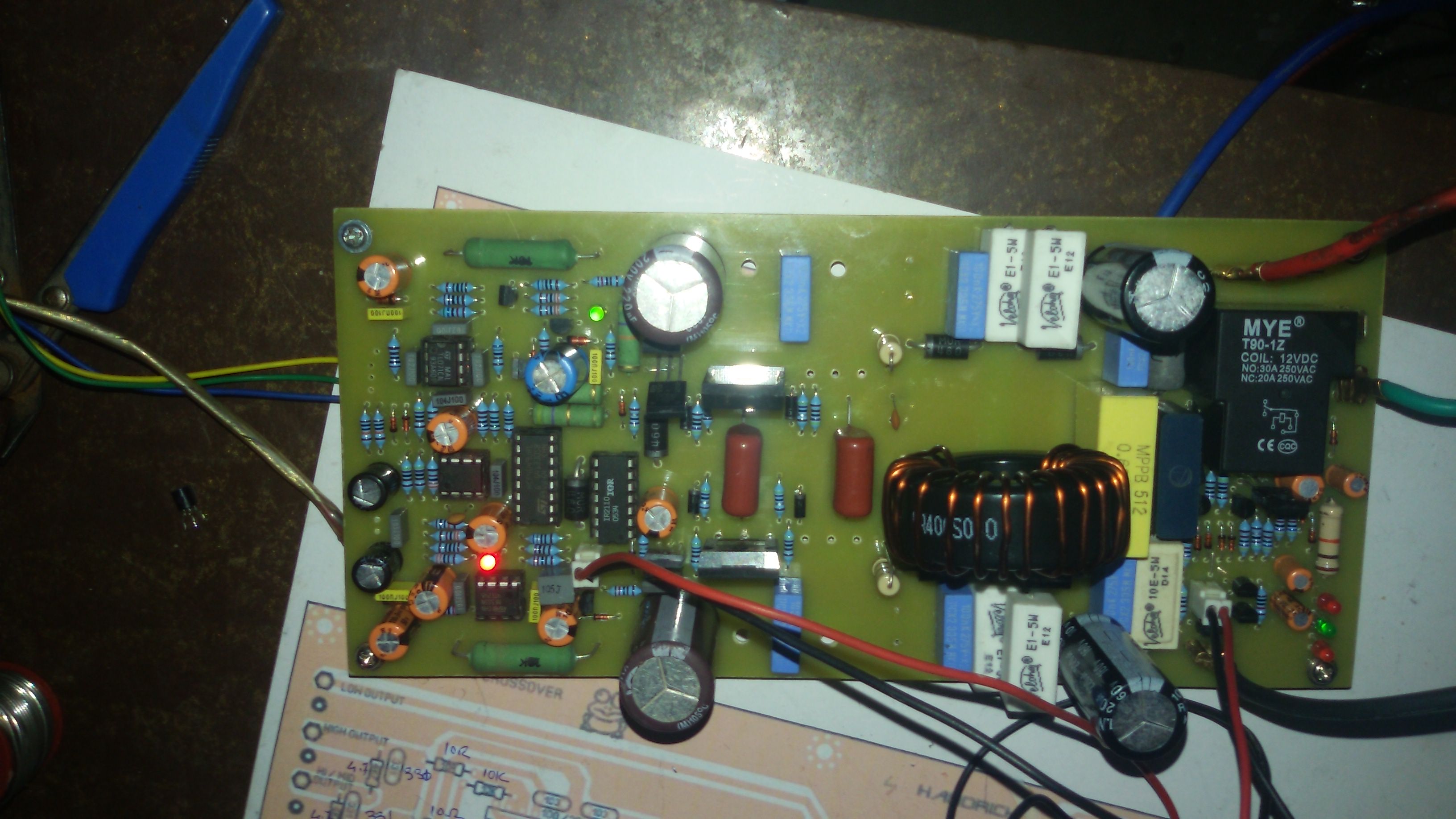

hi all by the grace of GOD i have finished a layout with ocp,dcp,ovp,uvp and soft start protections .the relays are small but i prefer using relays to reduce on pop and off discharging noise. i intend to use +/-85volts at 2ohms outputs are one pair irfb4227 .
if interested to make pls do and post photos and your experience.
have fun guyz😀😀
any ideas comments are welcomed😎😎
have fun guyz😀😀
D2k neo
Pcb done and chake
But now offset is -7 vdc

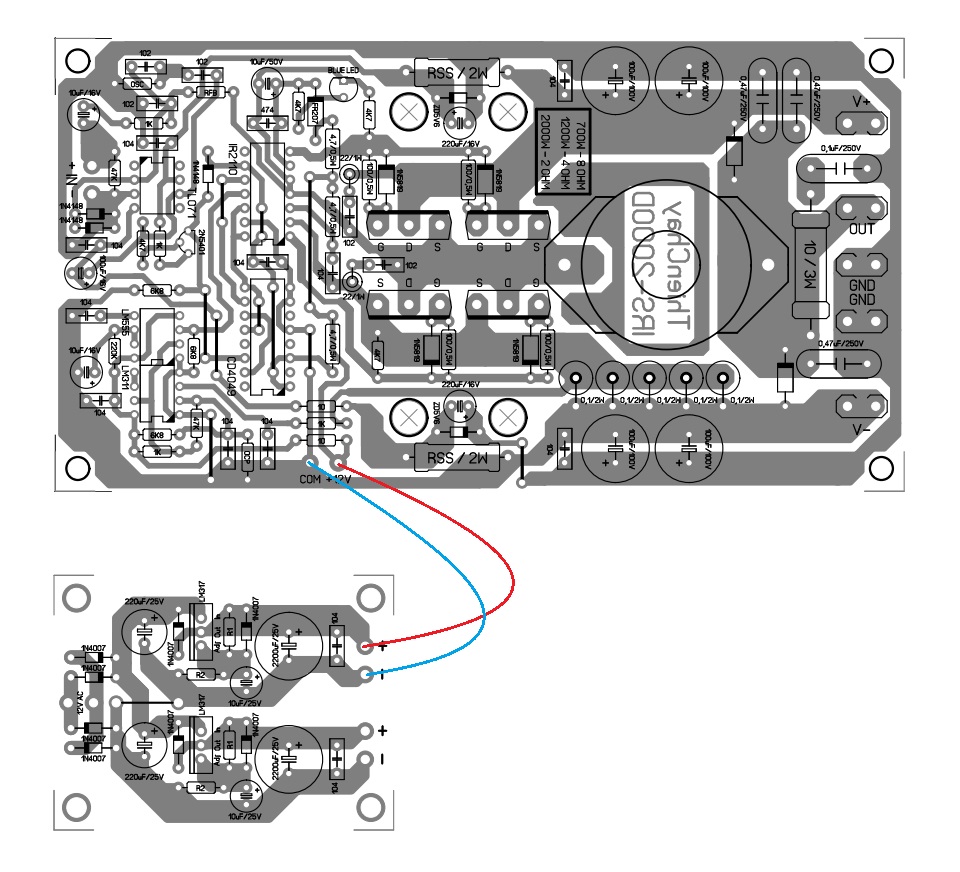

This is my Schematics D2KNeo and PCB picture. Just to give you idea, of maybe redraw from this picture. 2 sets mosfet Class D. I cannot give PDF of layout. You cannot just simply move this picture as some tracks are optimized to get very less capacitance hence as small as possible for small signal. Just give you idea.
It's not a problem. 20 mohm if it's cool. But no reason to shut down if cool. Protection is needed if MOSFET chip is hot, but then Rdson will be around 50 mOhm, so at 14 A it will shut down. This kind of protection is extremely effective if implemented well (correct timing, sensing for both polarity).
Sorry, but I don't have a complete drawing for half bridge, I implemented it in full bridge, with different parameters. Half bridge requires level shifting from high side, but basically every components required are there on the sch posted by Dinithm.
