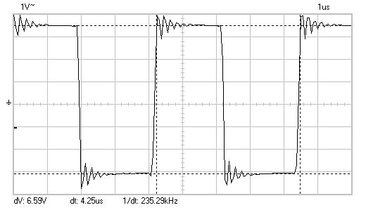

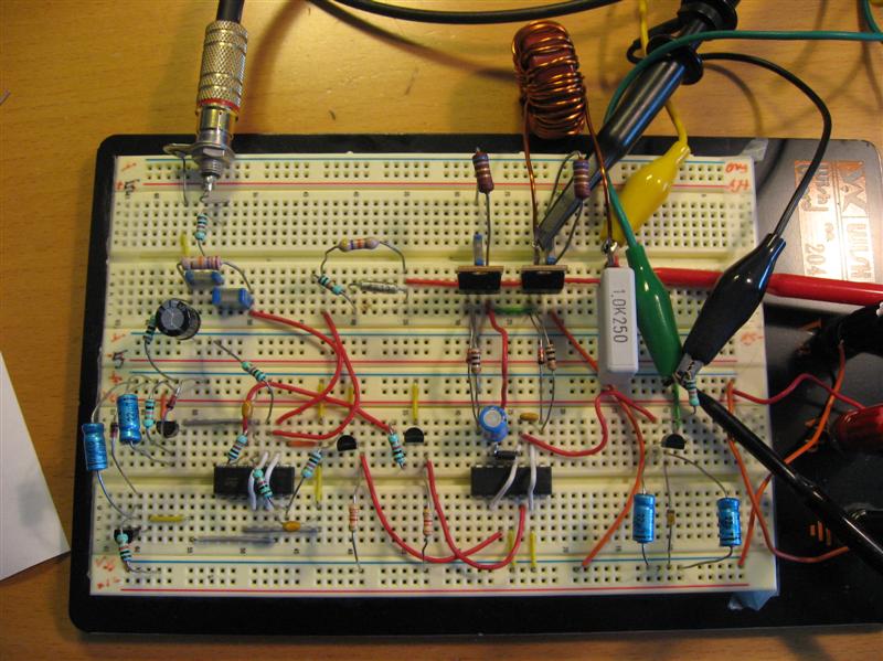

Works but ....
Ok. Changed a few components, and skipped the big capacitor in the input ...
Now it starts up every time, but only with a load (speaker or 8 ohm resistor).
Switching freq is 235 kHz
Because I had to remove the big cap ther is 0,6 V DC on the output .... need to find a solution ... any suggestions??
Also need ot find a way to make it start without the load ...
Otherwise it seems quite good for a breadboard circuit 😉
And I think it is an improvement over the original ........

Btw my switching frequency was around 7µS which is around what, 50-100kHz ?
The problem with the startup in selfoscillating class d amp usually is that it MUST start with the negative impulse at the output, to let the bootstrap capacitor charge (I mean the bootstrap capacitor of the mosfet driver). If this condition is not met (if the comparator waits for INITIAL positive impulse at the output), then the bootstrap capacitor is not charged yet, and it is not possible to open the high side mosfet and it is not possible to generate any positive voltage at the amp output. So the amp simply will not start to oscillate...
To solve this problem, it is usually enough to connect amp output to the positive voltage rail using 50K-100K resistor. This will generate small positive voltage offset at the amp output after power is on, and the input comparator will initiate the negative cycle first, which will charge driver's bootstrap capacitor effectively...
