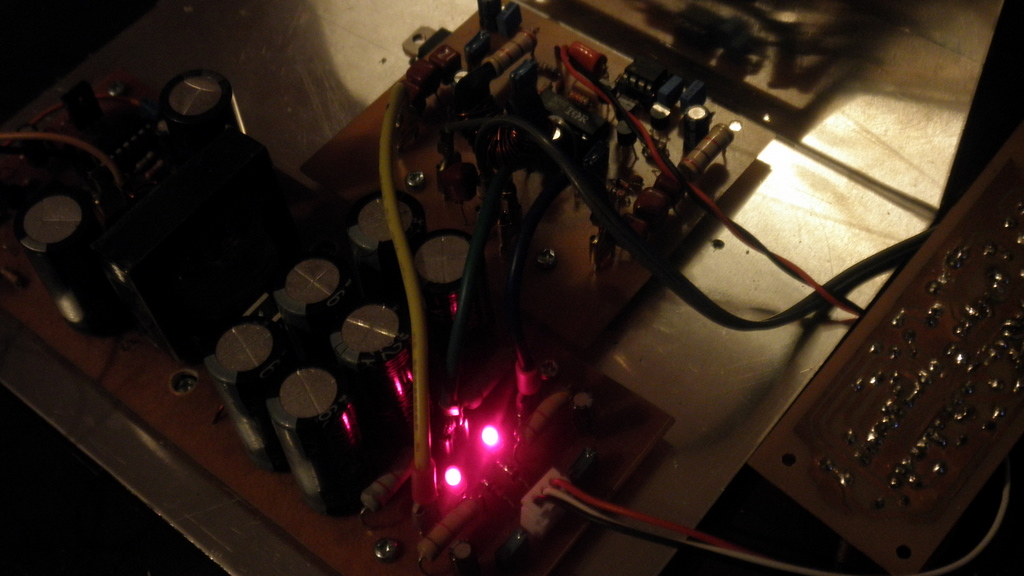

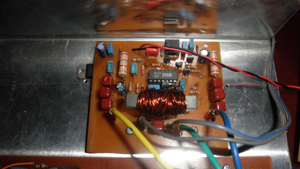

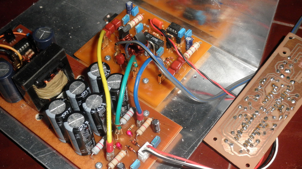

I have spend whole my last weak with this amp and winding inductors.. finally I could able to remove all switching noise.. sound is so perfect now..very low heat (only got the noise coming out from my PC 😀 ) and I learnt a lot of things about inductors. there are many things to concern when winding an inductor. not an easy task and to explain just by a post.. I ended up with winding my core on a ferrite stick taken by an E core.. (The 'I' part of an E-core) It was the best result .. may be I couldn't find a required toroid in my country sadly. I will send you more pictures later.. I should sleep a day now at least because I haven't sleep well for a week i guess :spin:
regards,
Lycanlk
Ended my amp with a good result..

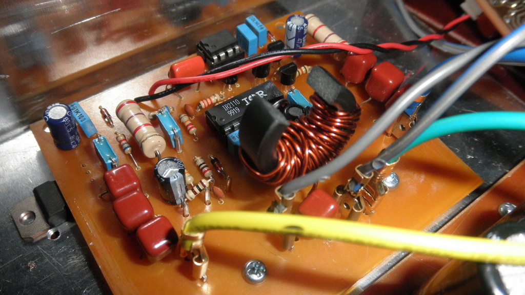

I could reduce 100% noise, I guess because I cant hear any 🙂 simply the amp wont generate noise.. It was my bad that I didn't measure the inductance.. (I didn't have a tool to measure) only followed theory.. but the real values are different. I did so many experiments with the amp. It doesn't even need a ground plane to work well !!! neither a dual layer PCB.. All you need to worry is to have a good inductor !
Still my inductor warms up due to low no of turns.. The coil heats up not the core! but its natural. i cant change no of turns caz it will affect to the inductance again. I can only try with a large core.
each and every ferrite has a working frequency.. if you go beyond that it will heat up! According to the author this amp works at 250Khz so if you select a toroid core at that frequencies, to achieve 30-40 uh you may only need 1 or 2 turns.. The amp will work well but the coil might burn in few seconds.. hahahaha.. so eventually you need to increase the no of turns.. but it will rise the inductance again.. Then the other option is select a toroid work on low frequencies.. then again the core will heat up ! This is so funny.. but its the nature where I could think out of the box !
I never give up on things easily.. So I do more and more experiments.. I found that I part of an E-Core gives a better result.. about 30 turns works well and less heat.. then I wound it on my broken toroid ..again 30 turns and 44uH.. amp works fine heating slightly.. I think about 70-80 Celsius..
I think ferrite sticks are the best solution!.. air coil is also good but it will be large and high resistance. Use common sense and do experiments and wind your own coil about 30-40uH. Amp will work well ! Its a nice design.. very simple and amazing sound.. many thanks to Ejtagle once again! and also Andrewlebon for starting this thread !
keep in mind more heat will change the inductance of the coil.. and it will start noising again due to change in uH value !

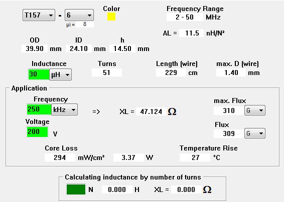

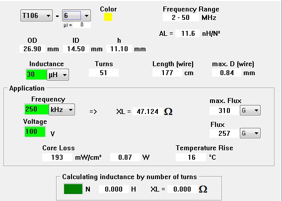

Agree with you ! we cant use toroid used for SMPS.. but its not because of low frequency.. but its because of the material they have made of. Because SMPS also works at high frequencies.. most of them are ferrite starting with FT numbers. They have high AL values.
Also Agree the material 2 (red) iron powder cores should work well ! but the best is material is 6 (yellow) anyway red cores are very much available on the web. follow the attached examples..
and thanks for the links! i'll try to get one.. at the moment their requesting server has got a problem. So I cant process my request !
