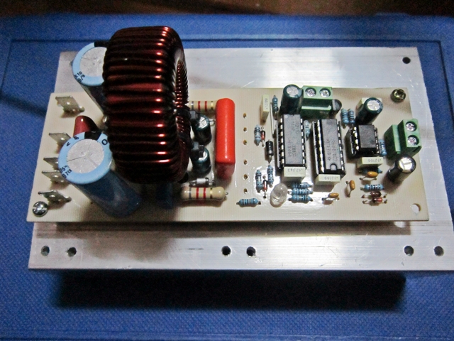

thanks jlister for sharing . but in the schema like the original ir900d you can't use +/- 65vlts or above comfortably . pls change the cd4049 stage to use three inverter buffer stage like irs1500 or aud ver 1 and 1.1 amps
The schematic is already tested, I created an earlier version of it (attached pictures) however I only used +-51V for the supplies. I don't have a power supply with a higher voltage right now.
If anyone can confirm that the IRS1500 is working for +-75V and up then we can adapt the three inverter buffer stage to the schematic.

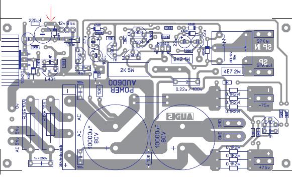

Smoke on my AUD600
Hi Manoj:
Yesterday I powered up my AUD600, Ver1.0. First I tested power board, DC rail was +-42 volt and found 12V DC with respect to GND at bias point.
Connected power to amp board without mounting any IC's and measured voltage, found 6.2 volts (Zener 6.3). TL071-072 had 6 volts of their VCC PINs.
It seemed that both the boards are okay and then I mounted all the IC's and connected all the power connection. Then I heard a pop noise and little smoke from NE555 IC area.
At the same time I saw smoke from IRF630 area (Power Board). There was a bulb (100W) in series with my transformer which flashed out in full. Drawing high current due to short circuit!!!
I measured bias voltage which is 29V with respect to GND, earlier this was 12V. Which part(s) may have been blown?
Can you please let me know which causing this problem? How to check the flaws of amp board? I did not attach those parts which are not recommended for first setup.
Waiting for your help.
Raj
Hi Raj
BIAS 12v is with respect to -ve supply rail only not GND.Connect 3pin BIAS point to amp board 3 pin
POWER Board AMP PCB
PIN=+12v-------------- +12v
PIN=(S)OC ------------ (S) center PIN
PIN=(-75V)------------ -Ve PIN
Regards
MANOJ

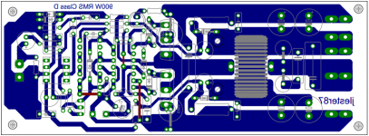

I'll gonna share my layout based on IRS900 / IRAUDAMP1.
I put the bias supply onboard and put an external OCP trigger so that the speaker protect will activate in case of short circuit.
Speaker protection circuit included.
Just don't remove my name when you etch the PCB. It gives me the credit for my effort.
