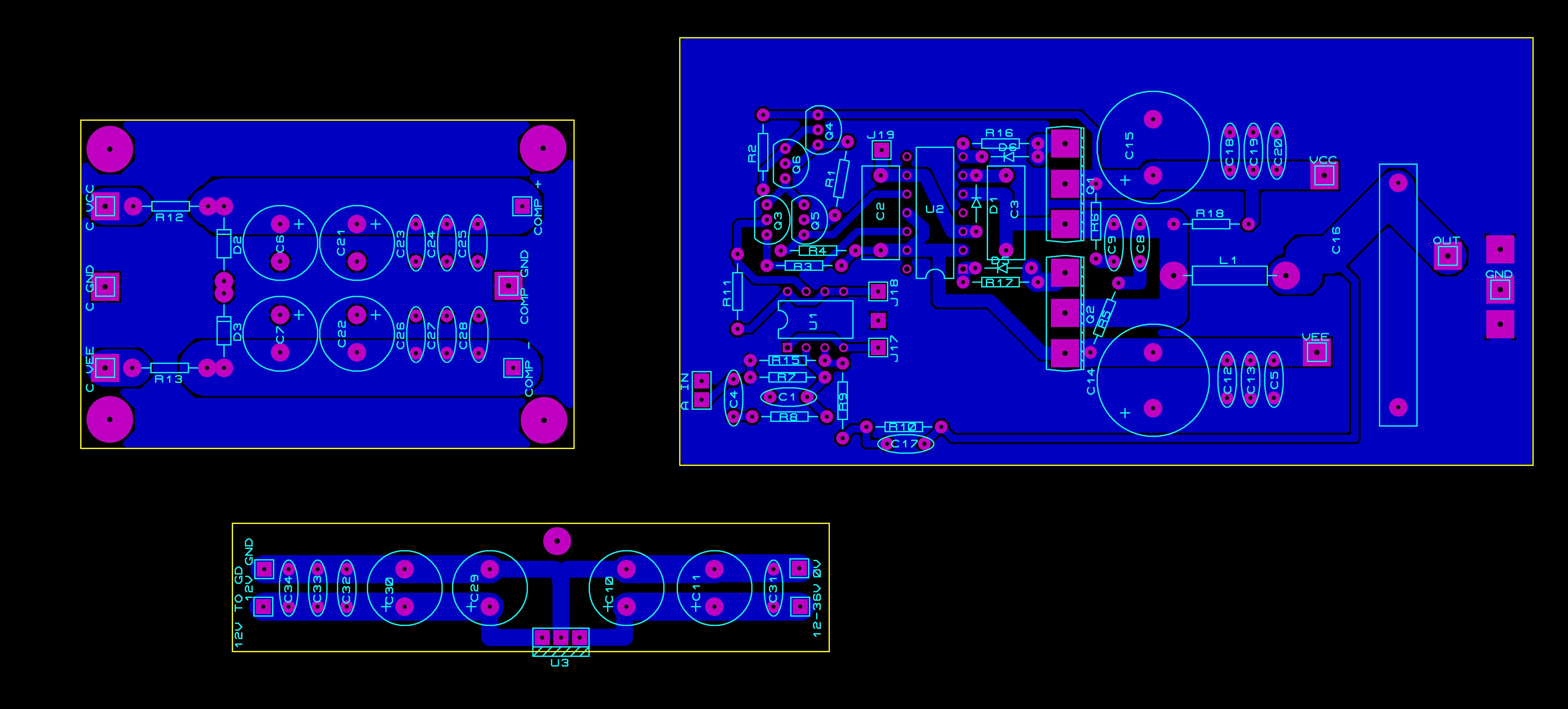

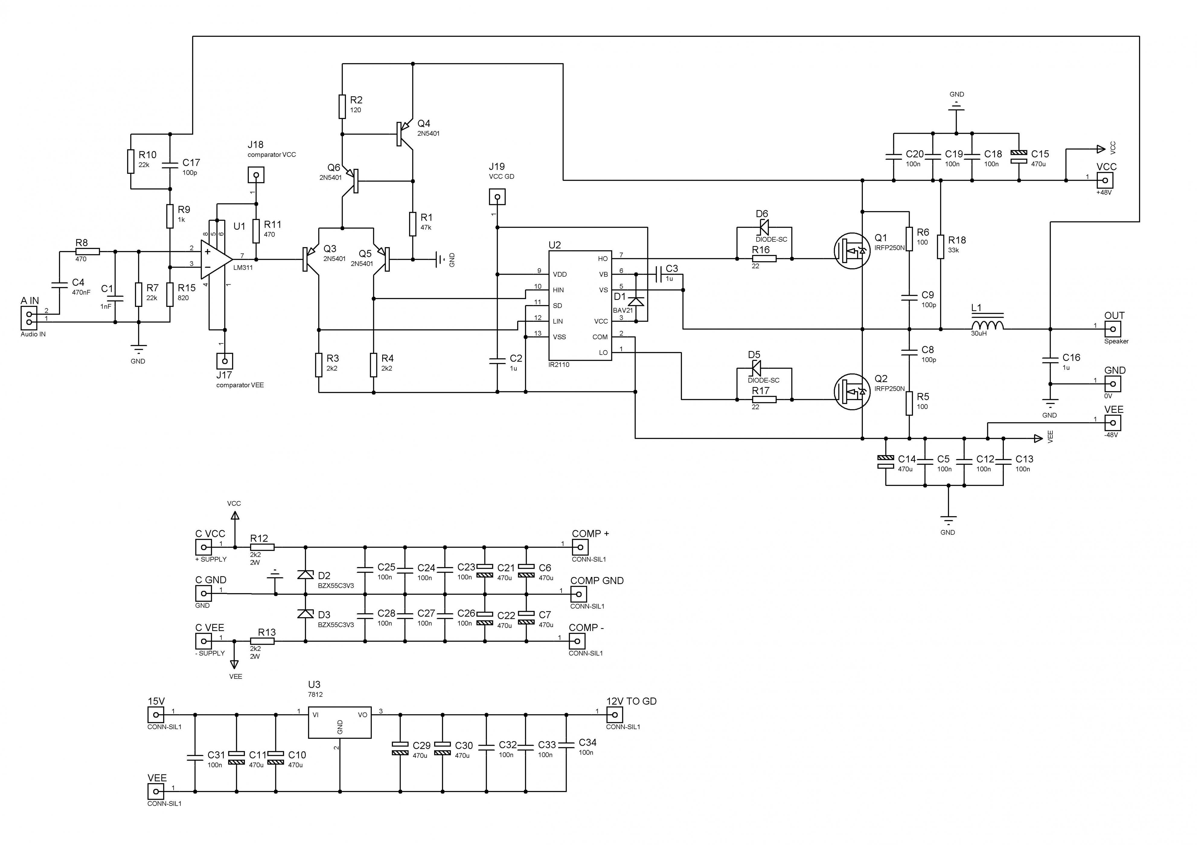

Hi
I'm kind of new to class D, so how's this?
Fets mount under the board.
supplies for comparator and ir2110 are one separate boards.
I plan on using it as a sub amp (if the board is good...)
also a stupid question, if I use it as a sub amp won't there be bus pumping? and if there is won't full bridge eliminate it?
Thanks in advance! and sorry if I wrote something stupid...
