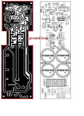

pcb
Are you sure the board works well? I see a huge ground loop .....
well i will post pcb after i make it and test it

greetings well this triell pcb has not been tested but it sells for 400$
well single sided pcb if well designed is not a problem for dclass amps my IR211O
WITH 3 PAIRS mosfets and zetex gate driver transistors i have no noise issues the ucd
amp has noise issues when placed in a cabinet ucd1200

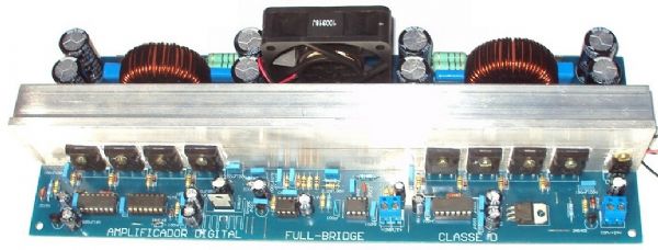

hers is a nice bridge design
