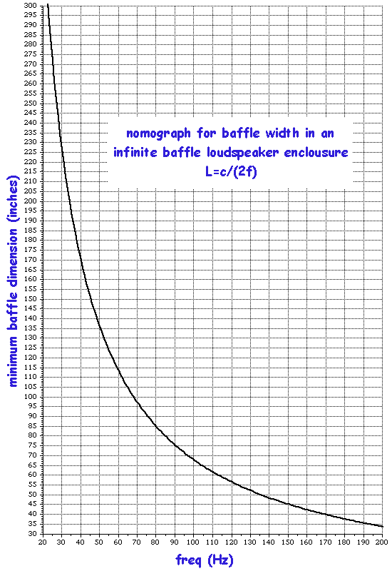

planet10 said:
To give you an idea of how big to go how low here is a chart based on Olsen.
dave
Your graph seems to prefer much larger baffles when compared to this :
jag said:Your graph seems to prefer much larger baffles when compared to
Mine is based on Olson's studies and i made it because the one you posted didn't jive with Olsen's or any other references i could dig up.
dave

A better way to describe it is that below the frequency where the baffle becomes too small to keep the back from canceling the front you get a 6 dB/octave rolloff. Above that it should be relatively flat. An example can be seen in the graph of Olson's i posted earlier in the thread and the cutoff can be approximated using the chart i posted a little later.
dave

And how big is big for the baffle by the way? In your graph,
which linear dimension is measured in the inch-axis?
Thanks and regards,
Tarun

Re: Re: the 6dB/octave rolloff
Olson's graph for the equidistant mounting shows a pretty big suckout.
The smallest baffle dimension.
dave
dave

Dipole Bass with a small baffle relies heavily on EQ to counter the roll-off. You have to have drivers with LOTs of air moving capacity & usually a lot of them.
dave
tcpip said:Thanks for the clarification. But in that case, how do
people do dipole bass drivers with just a flat baffle? Won't
all "normal" baffle sizes be too small? Does this mean
that for normal sized woofers, you'll have to go either
with boxes or Linkwitz or Lynn Olson's style of dipole
arrangement? I guess so, right?
dave
Damn! I've been using that same chart that Jaq posted! It's a real classic. Dave, could you check your calcs again? Lot of people might be jumping off buildings in mid speaker construction.
Also, does ALL the sound "short circuit" around the narowest dimension? or is it just a percentage?
tcpip, I'd say try an open baffle. Because the bass is really exceptional compared to a ported enclosure (never heard a high quality sealed box before). I get usuable bass from around 45Hz up to between 100Hz and 200Hz (where the driver is crossed over). And in another thread Peter said that his 15" focal goes down to 25Hz (I do believe he said not eq'd) in a relatively small folded baffle (the dimentions wouldn't lead you to believe that it would go down to 25Hz). So it's worth a try to see how your jordan will sound, just slap it into a huge baffle to get an idea and then work from there. Try using this excel spreadsheet to get an idea of how your driver will preform, I found it pretty usefull ( http://melhuish.org/audio/Xlbaffle.xls ).
Variac, the frequencies that the graphs show (which ever is the correct one) would probably be the -3dB points (just a guess, but it makes sense) and the driver will drop 6dB an octave after that (although I'm not sure how the driver will act below resonance).
