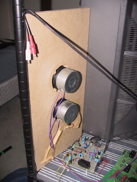

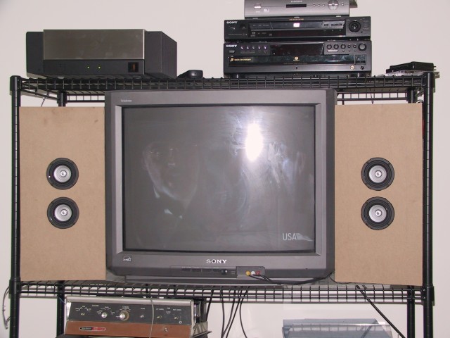

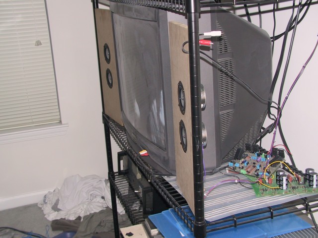

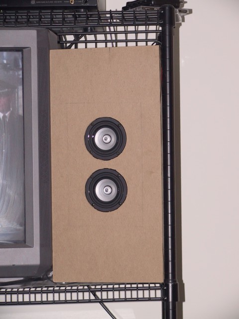

After seeing the w3-871s on an open baffle, I got bored today, and threw together a quick pair of open baffle w3-871s speakers. I bought a bunch of the w3-871s drivers to build them in a ported enclosure (6.5"x10.5"x9", based on Jim Griffin's elf 1.5 design). They sound pretty good on the open baffle.
Here are some pictures:
Brian

I had then mdf pieces that I cut before to build a sealed tempest subwoofer to compare to my ported tempest, but I never go around to build it. They are just the internal brace pieces for it. I was amazed that they happened to fit perfectly next to both sides of my television.
Brian
Brian
They make much better television speakers. I have driven them with both a gainclone and my leach amp. They get fairly loud with both. When up too loud, they really distort on bass notes, but this is much higher then my average listening volume.
The top speaker is run full range, and the bottom speakers is in series with a 4 ohm resistor and a 1.5mH aircore inductor in series. I just used some packing tape to secure the components to the back of the baffle.
All of the wiring is just 18ga teflon insulated silver coated copper hookup wire, running straight from the drivers to the amp.
Brian

They took me a couple of hours to build total, since I already had the wood cut. I used a jasper circle cutting jig with my plunge router, and countersinked the drivers flush. I also used a straight cutting bit to give the drivers room to breath by cutting the holes larger away from the mounting holes. This really helps the performance of these speakers.
Overall, this is just $50 in parts for 2 speakers. They sound quite good for the highs and mids, but need a subwoofer to fill in the lower bass region. I am satisified, and will compare these to the ported box with the same drivers.
Brian
