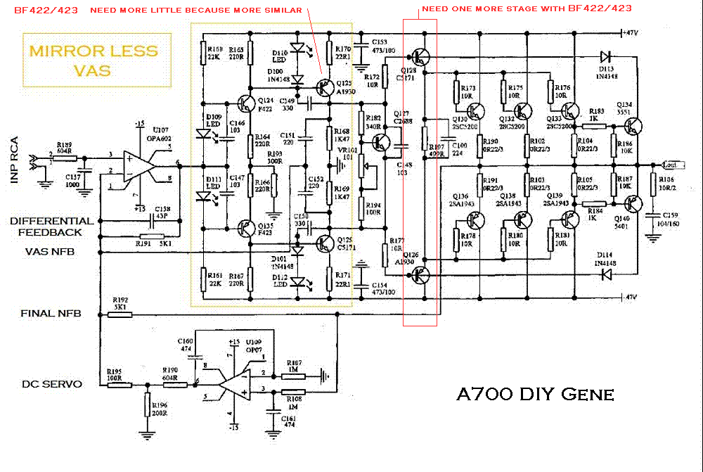

My question is more, what's 'universal' about this?
Gentleman reinvented a bicycle. A very good one.

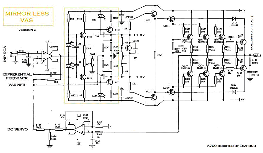

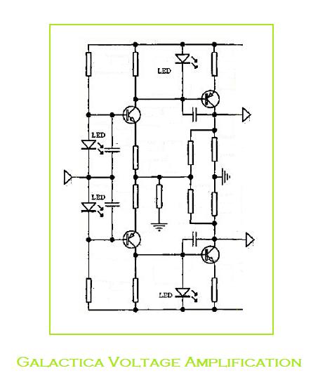

those 2 LED in output stage
are those for just protection?
if you have more than 1.65 Volt across them, at working bias
they will block the output from more output current
= clip the top of your signals (current limit)
not bad!
can i build it and get it to work alright?
i guess you will try to make some prototype
because your ideas are interesting
they deserve some real life testing, too

Re: inventing solutions
I'm sorry to say that but most of your ideas wouldn't work anyway. I mean the ones related to electronics design, because the ones related to marketing are actually quite good.
Stee said:of course
Most of my ideas are never implemented
serves to maintain a vision of all🙂

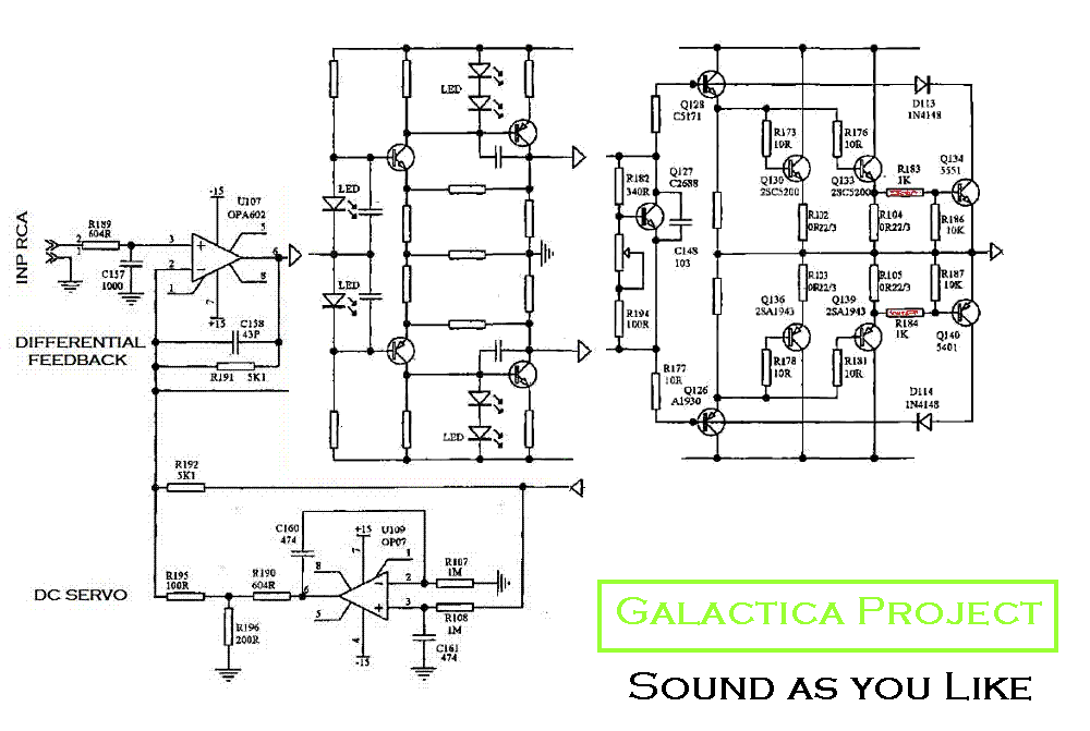

Re: Galactica Project
...frying 1'st transistors (right after opamp) trying to understand what they don't like... 😀
Stee said:lineup
if you like
we can make this project togheter 🙂

Is this really a Levinson no.331? I dont think it is, single ended firstly.
Does the real levinson use opamps?
I expect your right. The 331, 332, 333 are the 3 different power ratings of the same range, so I expect similar topology with more output.
The 334, 335, 336 are the next gerneration of this amp. Its fair to assume the topology is similar.

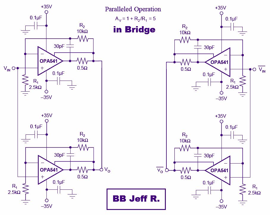

Its interesting, the plinius sa250 family I believe use opamp inputs too and these are big buck amps too, Im not sure I think they are worth the money, but build quality is very high and as allways in hifi its personal preference.
Luke Im not an opamp fan at all, but I have to admit there are some new opamps in the market now which are very good, discrete cannot compete spec wise wise but there is differences in sound, but then again there is differences between different discretes too. Jeff rowland uses gainclones in his amps now and some say they sound awesome, can be confusing. I believe the best amp is the one that sounds the best to your own ears, one one should compare various amps, component matching plays a role too. I have electrocompaniet monoblocks which is my preference for my speakers and cdplayer. Ive built stochino diy amps with slight modifications and some family members which are musicians prefer their sound, the price difference is in the 1000s of euros. I agree that build quality and component quality is of prime importance.
