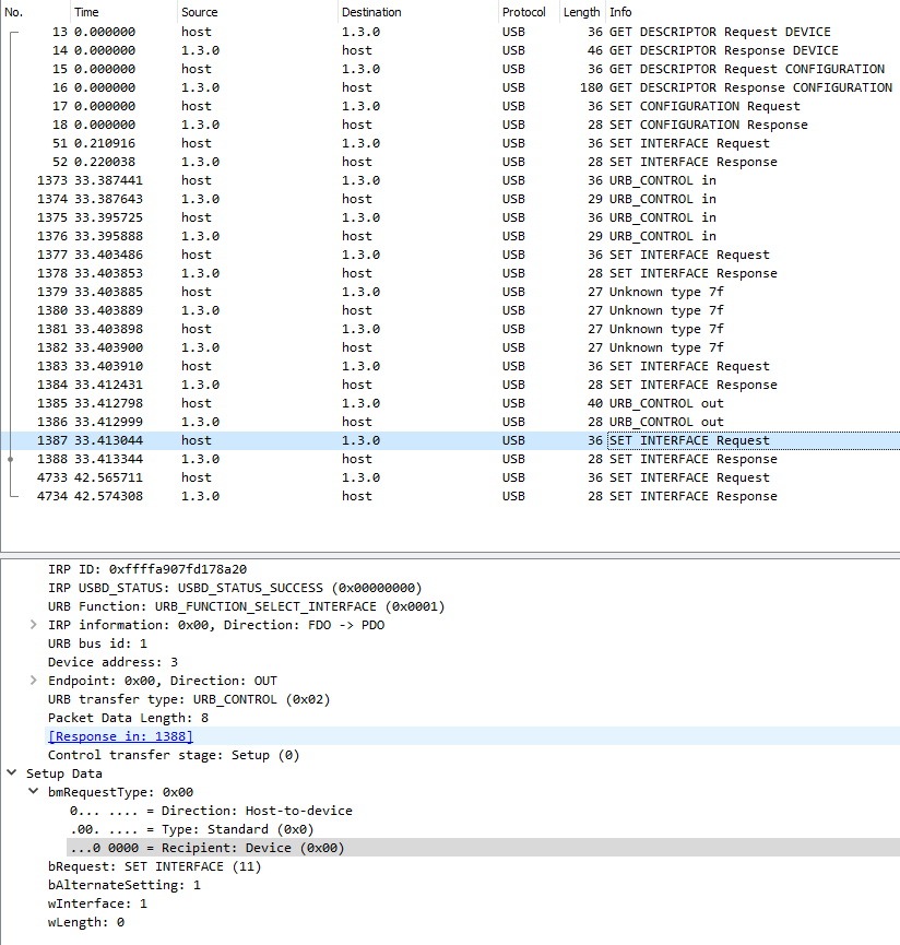

Yes, host does send a "Set Interface" request.Did host send a "Set Interface" request to select the alternate setting of your output interface?
Yes, USBD_LL_PrepareReceive() is called.You should then make the first call to USBD_LL_PrepareReceive() for receiving data from host.

No. I will describe the situation step by step:So you get SOF interrupts, transmit feedback but host does not appear to get them?
1) Plug device into PC, audio stream is not active. Device starts getting SOF interrupts.
2) Start audio stream. Device starts getting Data Out interrupts, receiving audio data and filling it's buffer.
3) As the buffer is filled half of it's size, SAI starts outputting data from the buffer and variable flag is changed to indicate that feedback is allowed to be sent.
4) In the nearest SOF interrupt feedback is transmitted for the first time.
5) After transmitting feedback (step 4) device stops getting Data Out interrupts and audio data is not received any more.
6) From step 5 device only get SOF interrupts and transmit feedback, but it do not receive audio data. Nethertheless I do not get Iso Incomplete interrrupts in device; Windows UAC2.0 log does not contain errors and says audio stream is running and feedback stream is running. It seems like IN packets block OUT packets in device side.

Well, after many experiments I think the solution is found. Poll interval of data endpoint is encreased to 250 us (bInterval = 2), poll interval of feedback endpoint is encreased to 1 ms (bInterval = 4).
After several hours of streaming device seems to work without transfer errors, it receives audio data and send feedback.
Now I need to correct feedback value in accordance to new poll interval and test for sound correctness and pureness.
