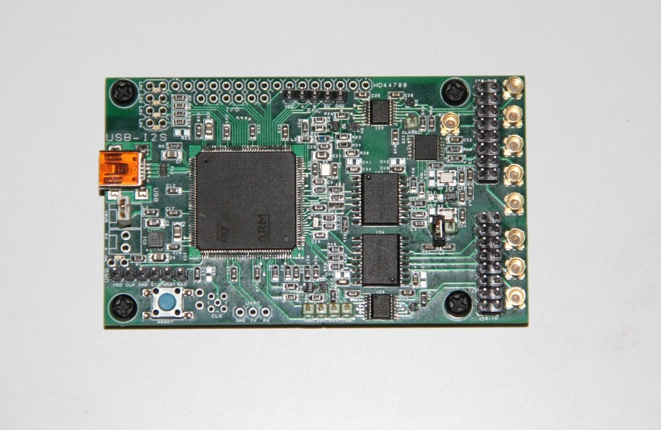

If the aim is to produce an open source USB to I2S interface that supports PCM & DSD, I would be willing to design a high quality prototype PCB to test out how it sounds. And make the pcb design open source of course.
The board has existed quite some time already: https://www.diyaudio.com/community/...trumentation-applications.347854/post-6839058
Has both I2S output and input with up to 768k/32 simultaneous play & record.
Here is a picture of a later board revision with MMCX connectors.
Reactions: EvSap
