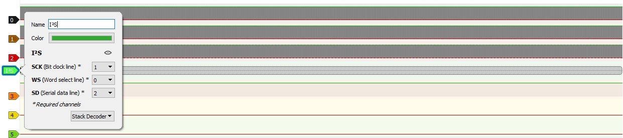

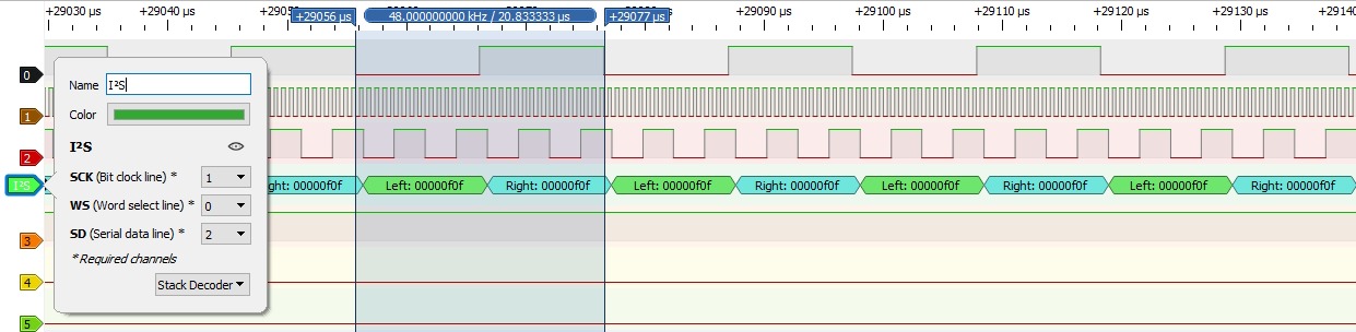

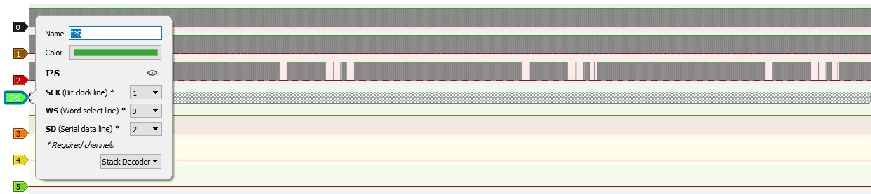

For those who may be interested in SAI behaviour with Data Cache enabled / disabled, what I tried explaining in the previous post, here are diagrams received by means of a logic analyzer.
1) Data Cache enabled. It is seen that data (line 2) are lost periodically
2) Data Cache disabled. It is seen that data are never lost, transmitted permanently.
3) Data Cache disabled, previous diagram is zoomed in, test data 0x0F are transmitted.

D-Cache and DMA is terrible in STM32F7/H7.The reason of strange SAI behaviour was Data Cache.
As disable D-Cache at all is not a good idea for other firmware parts, it is better to make the separate RAM area for DMA buffers, and define it with MPU as "non cacheable", while other RAM remains cacheable.
