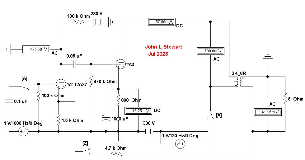

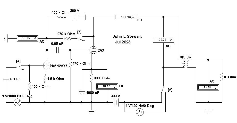

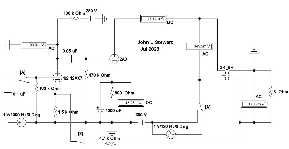

Simulation of a typical SE amplifier to show the effect of a One Volt PS hum. With or without Schade NFB. And what that looks like on the secondary of the OPT under load. Altho any working amp would not have One Volt of hum this value allows easy calculation to any other hum number.
The simulation has two switches to setup various conditions. On the Keyboard switch ‘A’ is a DPDT that allows looking at the hum only or switching to a normally driven amp. That way several calculations are possible. Switch ‘Z’ applies Schade NFB.
In Test 1 the one Volt of PS hum translates to 41.08 mv on the OPT secondary. In Test 2 Schade NFB is applied & the One Volt PS hum increases to 45.03 mv.

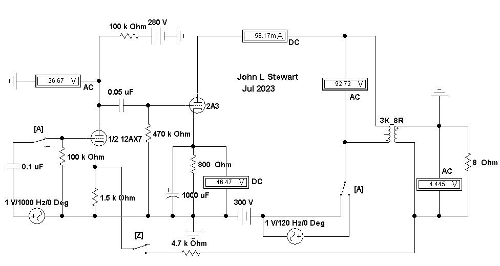

In Test 3 Switch ‘A’ is set to the other condition, the circuit becomes an ordinary amplifier. With switch ‘Z’ open there is no FB. Power output to the load is about 2.5 watts with a One Volt driving signal. The gain of the 2A3 is ~3.5.

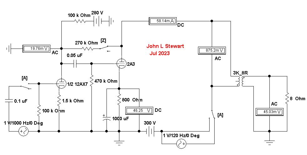

In Test 4 the Schade NFB of ~5.6 db is applied by closing switch ‘Z’. Gain of the 2A3 remains ~3.5. But now the half AX7 must drive its 100K plate load & the following 2A3 grid resister of 470 K in parallel along with the Schade resistor. In the FB network the Schade resister looks like 270K / A+1 where A is the gain of the 2A3. So becomes 270K / 4.5 or 60K. The three resistances in parallel calc out to 34.7K , an intolerable load for half an AX7. All easy to do on an RPN calculater. 👍

Interesting investigation. Did you draw any comclusions wrt the PSRR of the circuits, or a recommended way to minimise it?
Jan
Hey JonS, good to know you are out there in cyber space keeping track of those of us who might defy Gravity & good engineering. But you missed the intention of this Sim, the title clearly states PS hum & that is reinforced by the position of the One Volt interference generator in the schematic. I’m confident that you have successfully interpreted many schematics in the past.

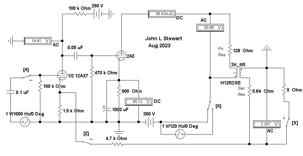

So continuing with this exercise, in Test A the Schade NFB circuit has been removed & replaced with a NFB connexion common in amplifiers of the socalled ‘Golden Age’ of vacuum tube amplifiers. Without NFB, the circuit performs essentially the same as in Test 1 as we might expect.
In Test B about 5.8 db of NFB is switched in, about the same degree as in Test 2 with Schade NFB. But in this circuit the hum at the OPT secondary is about half what it is without NFB, in contrast to the increased hum problem with the Schade connexion.
In Test C the gain of the 2A3 is still ~3.5. The load on the driving half AX7 is simply 100K in parallel with 470K, ~82.5K.
In Test D with 5.8 db NFB the load on the driver remains 82.5K, much less difficult to drive than while in the Schade circuit.
Which leads to the question, why would anyone building an amp use Schade NFB in this simple circuit? But many do now in contrast to the past.
In the next exciting episode I’ll have a look at the Damping Factor of these circuits. And use some real numbers for the resistance of the OPT primary & secondary. Those matter a lot.
JanD, I’ll run some Sims on the PSRRs as well.👍

Yes that would be of interest. The way this is normally done is that you impose an ac signal on B+ and look how much of it turns up at the output, with shorted amp input of course.

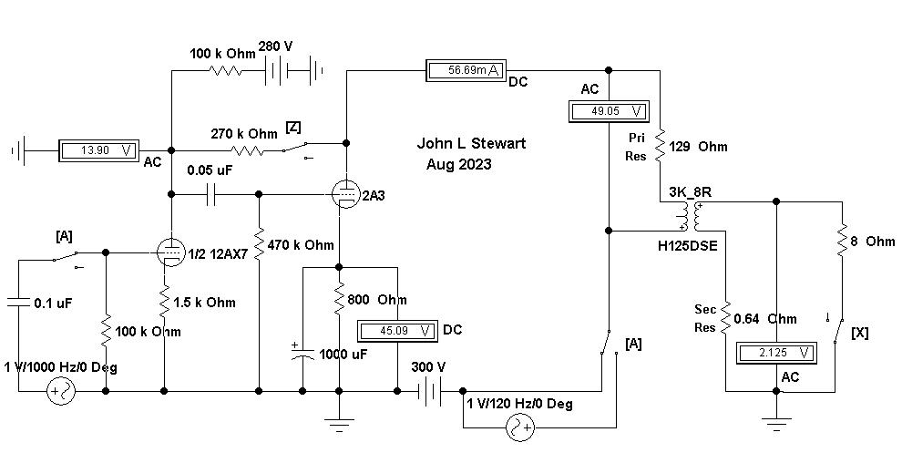

For these tests an OPT, the Hammond 125DSE has been connected to the circuit. And then tests for the internal resistance of the amp with & without normal NFB of about 6 db. The measurement results are as follows—
No NFB 8R load on OPT secondary, 4.07V
No Load on OPT Secondary, 5.76V
Rint = Delta E / Delta I……………….Delta E = 5.76V – 4.07V
And Delta I = 4.07V / 8R…………….0.51A
So Rint = 1.69 / 0.51…………………..3.31R
DF = 8 / 3.31………………………………………..2.41…………….about right for a 2A3 with Zero NFB.
With ~6 db NFB 8R load on OPT secondary, 2.208V
No Load on OPT Secondary, 2.525V
Rint = Delta E / Delta I……………….Delta E = 2.525V –2.208V
And Delta I = 2.208V / 8R…………….0.28A
So Rint = 0.32 / 0.28…………………..1.15R
DF = 8 / 1.15………………………………………..6.96…………….Better control of the lautscprecher
A 2V input will drive the 2A3 to 2.5 Watts with the NFB connected.
A One Volt Interference signal on the PS lead results in ~383 mV across the OPT primary.
That would be PSRR at that point of 8.3 db, we need a good PS filter on this one.
More later, same circuit but with Schade NFB for comparison.

For these tests with Schade NFB an OPT, the Hammond 125DSE has been connected to the circuit.
And then tests for the internal resistance of the amp with & without Schade NFB of about 6 db.
Rint = Delta E / Delta I……………….Delta E = 5.76V – 4.07V……………same as with common NFB
With ~6 db Schade NFB 8R load on OPT secondary, 2.801V
No Load on OPT Secondary, 2.125V
Rint = Delta E / Delta I……………….Delta E = 2.801V –2.125V
And Delta I = 2.208V / 8R…………….0.27A
So Rint = 0.32 / 0.27…………………..2.54R
DF = 8 / 2.54……3.14…………….About one half as in common NFB with same degree of NFB
A One Volt Interference signal on the PS lead results in ~890 mV across the OPT primary.
That would be PSRR at that point of 1.0 db, we need a very good PS filter on this one. 🙂
Results with the common NFB are clearly better. Something to think about as we build our amps.
More later, lets have a look at the AX7 loading by the Schade NFB,👍
