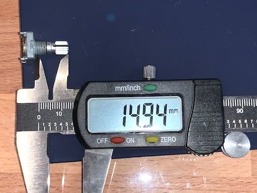

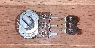

We NEED body size caliper measurements (please use mm) and specially pin to pin separation or it will not fit in the PCB
From your picture comparing pins to those of the much larger round one, I measure 3.6mm pin to pin separation.
The one you bought shows 2.5mm so it will NOT fit.
* please confirm hole center to hole center separation at the PCB, first carefully remove broken pot from it, you will need to anyway.
Measure between the most separate ones for better precision.
* just to help in search, please measure square body size, although the measurement you NEED to meet is pin to pin separation.
* matching shaft specs will also help, but as mentioned above is not *that* critical, worst case you use another knob or even leave it bare and twist it with your fingers
EDIT: body "should" be around 11.5mm but please confirm.

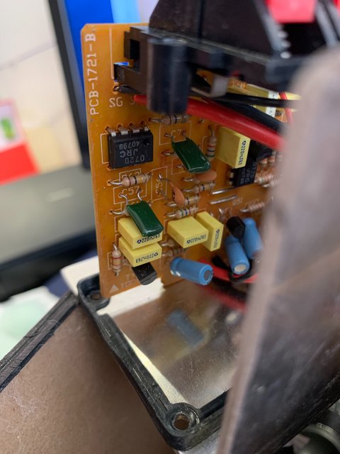

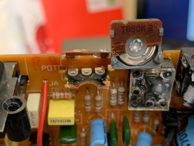

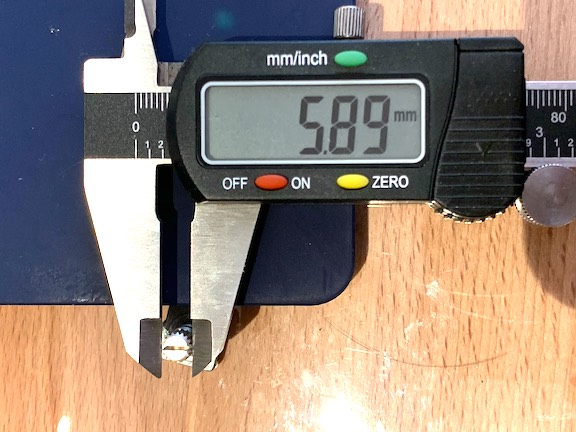

Caliper shows ≈ 7.5mm pin span between 1st and 3rd pin on board for pot. Height from board mount surface to center of shaft ≈ 9mm, so giving some room for tolerance the 10mm height option "20" looks right. Body is ≈ 12.5 x 12.5mm, with board material holding 3 pins extending downward slightly narrower (≈ 12.1mm).

Success! There was a lot of residue from my amateur soldering job around the pot and audio-in jack reflow. Presumably it was flux residue, which is visible in my prior post with pics. Using a Q-Tip, Xacto knife, and DeoxIT D5, once I cleaned the channel below the crackling went away. I guess the flux residue was conductive to a certain degree.

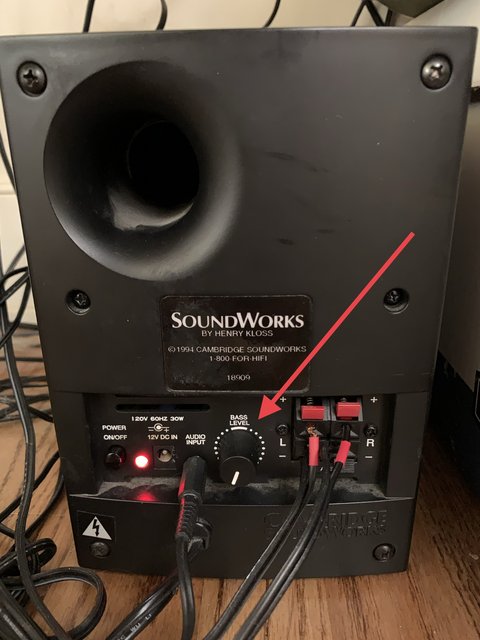

By the way, at the bottom you can see prior knob against new one. I think it looks better than OEM's version!
