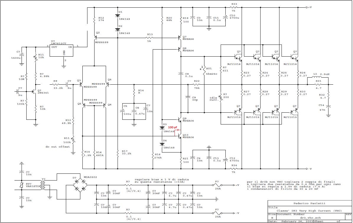

do you have a scope, that sounds like the amp is oscillating when a load is attached. A scope would help to check.
Check the zorbel cap and resistor, C9 ,C5-7 and D3/4.
check the rail resistorsR33/34.
If it is oscillating a Miller? cap (100pf) across BC of Q10 may help

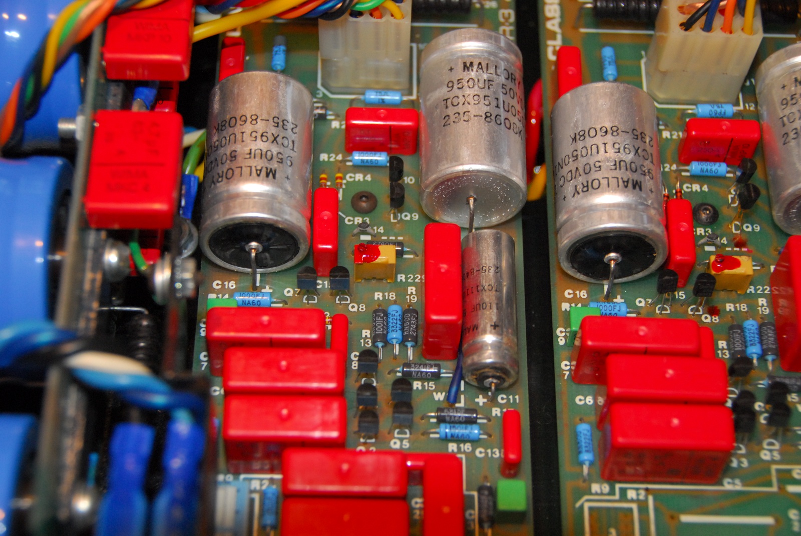

I´m not a technician and do not have a scope but all the caps you mentioned are those red and green WIMA´s.
The Zobel cap is C14 and the resistor is R31 inside the 2.5mH inductor probably?
The only way to check that resistor is to desolder the inductor I think.
With D3/4 you mean the Diodes CR-3 and CR-4.
On the attached image you can see that these have been replaced also in the problem channel.
Miller Cap and Scope
I'm bidding on a Tektronix 2225 right now.
Miller cap like this:
