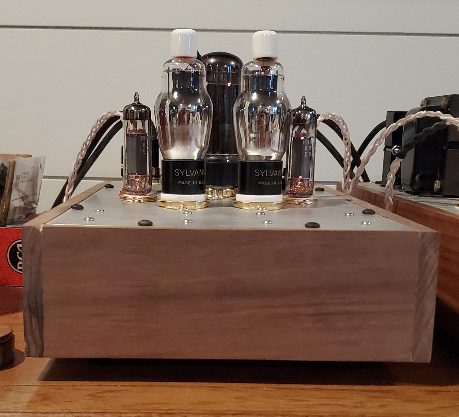

Type 85 Tube E80L Triode Strapped Zen Inspired Amplifier Build
I won a box of Type 85 triode tubes at an auction and wanted to use them in a new build and already had a stash of E80L
. It is inspired by the Zen Triode by Decware. The E80L is similar to the Russian 6P15P-EV that they use, only more linear. I am Very happy with the sound of this simple, basic amp. The 85 is a fine low mu triode. I am so happy I bought those.

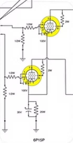

From the schematic I see that g3 of E80L is floating. It should be connected to ground or to plate.
When connected to plate you get a bit higher gm and lower rp.
Maybe a bit more power too.
There is also mentioned in the schematic, that cathode circuit of two E80L tubes are shared.
That is a bad desing flaw.
Separate cathode resistors (and capacitors) should always be used.
Thanks for looking. The g3 pin is tied to the cathode by a .1uF cap. Also, if you look up the Decware schematic, he ties the cathodes. I thought, like you, that they should be separate, but he explains the rational in his video about the amp. It tends to balance the tubes. I looked into it and found that it is done sometimes. Hey, I had a bunch of tubes and hardware and thought I'd try out his design scheme to see how it performed. Check out his video here:
On the Decware website you can go to this amp and scroll down to the schematic. Here's a screen grab.

Artosalo, I took some time to think about your comments. Do you realize that you, 1-didn't ask why I used the schematic that I chose, 2-you assumed that I don't know what I'm doing and 3-you told Steve Deckert that he sucks as a amplifier designer. You also made blanket statements about one of the most talked about amps on the internet. The guy has something like a 2 year waiting list. My hobby is designing amplifiers from scratch and building them. This was the first time in several years that I've tried someone elses design just to see how it sounded. Of course I did it with different tubes, because I wanted to. Now anyone who looks at my post is going to see your comments and think it's a bad design because you didn't think that you might be able to learn something new along the way. I guess you're the world authority on tube amplifier design.
This is a very good sounding amplifier. It uses tubes that not many people are used to seeing. It proves that what you called a bad design flaw is actually something that works quite well.

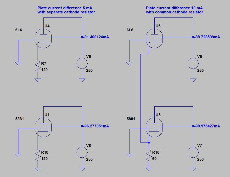

Here is an simulated example of the effect of common cathode resistor vs. separate resistors to plate current of each tube.
The simulation is made with 6L6 and 5881 tubes, since these are very similar but still there is a small difference, which is required for the simulation.

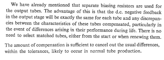

The following is a passage from pages 47 and 49 of the book "Hi-Fi Amplifier Circuits" by E. Rodenhuis (Philips, 1965) about the advantage of using seperate cathode resistors for the two power tubes (EL84's) in a push-pull output stage.
So, according to this passage the opposite of what is stated in the video is true. Separate cathode resistors compensate for differences in characterisitics of the tubes d.c. current wise.
This supports what artosalo already put forward.
