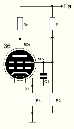

Cathode biased but I don't see a cathode bypass cap. But see a cap screen to cathode. Is that correct?

42 tube in triode is about 1W of nice sound. In pentode mode more than 3W.
I know two options for grid capacitor - to ground and to cathode. I like to cathode. You can try both with good film capacitor about 4-8uF.
Cap in the cathode at your discretion. Try both options too.

Thanks. Will do.
Do you think the cathode bypass cap needs to be high quality? I think its more of a filter cap like whats in the PS - holding voltage steady. Right?

In my opinion all capacitors need to be high quality.
Waiting for results. And be sure to try 36 in triode mode.
