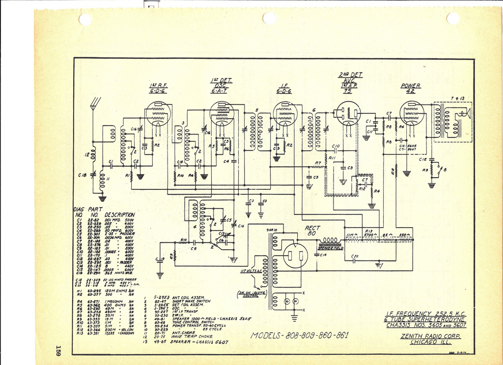

I picked up a couple Type 42 tubes from a lot this weekend. They look so classic that I want to build a single ended very vintage hi-fi (yes, I some may think this is a mis-use of the word) amp around them. I know I won't get much power and there's lots of talk about distortion, but I think I could work around it and be happy with the results.
Because part of the attraction is the "look" I want to stay with a 2 digit 6 pin driver. What is everyone's thoughts for a driver. To my uninformed search, it seems a type 76 is what I should target.
Thoughts?
If anyone has a schematic that would be nice also.

76 and 37 have very low gain especially for triode operation of the 42. I can't think of a high-mu tube without a plate cap - so a 75 is the obvious choice. UL or plate-to-plate feedback will reduce distortion without much affect on output power, or global feedback can be used .

So just wire 36 up like any driver tube? I'm planning cathode bias on the driver.
How about 250 on the plates of both driver and power tube. Triode strap the 36 and enough plate resistance to keep below 3.2ma on the plate and cathode resistor enough to idle at -3 on G1. I don't have plate curves or a good data sheet, so will need to do better math later. Sound about right?

6-pin base with 6.3v filament... 75 high-mu triode or type 77 (may be in triode mode), but both of them with plate cap.
The excellent option is 53, but the filament is 5v.
6V equivalent is 6A6 or octal 6N7G. Dual triode with common cathode. If you bypass the cathode you can use half for each channel.

75, 76? 75s has a high mu of 100 a lot like a 12AX7, but they have two diodes which I just ground off & ignore. You will want to shield that 76! I have used the 42 myself, in lap steel, and harp amps, with either a 75 or a 76 tube for a driver SE, or 3 or 4 of them for push pull amps. They look cool, & done right they can sound quite nice too! The 76 is a bit like a 6C6 which was also used in OLD lap steel amps. Those are always shielded in the old Goat type shields. Thick copper foil with a ground wire will work too. Carefully cut or fold the foil to contour to the tube, & solder on a ground wire. Mark where the foil meets up take it off & solder those points until it fits fairly well, then wrap the tube & tack the foil together with more solder. I have seen the foil method more in English radios, & some test gear, but it is done. You can get those Goat style split shields on eBay too.

So at this point its gonna be a 42 SE (not sure about Triode or UL or Pentode – will prolly try all 3. If UL works, that is my plan “A”) with 36 triode strapped drivers.
I want to run the 36 triode strapped and with local feedback. So given the screen’s 90v limitation, how should I implement as a triode? A dropping resistor from Plate to Screen or a dividing network (2 resistors in series from plate to ground and the Screen coming off between the 2 resistors)?
As someone pointed out the 36 driver curves have a lot of distortion. Does local feedback make sense? Is it needed to make the driver more linear. What did you do oleg? BTW this is a hi-fi amp, not an instrument amp.

I used type 42 tubes. I liked the sound of both pentode and a triode. You can make the switch and quickly choose the mode. What output transformers will you use?
In my amplifier 36 tube is in pentode mode. I use a two resistors in series for screen limitation. Also potentiometer can be used for the selection of these resistances. I did not do any feedbacks, but I think you should necessarily try it.

When you wired your 36 screen supply, did the 2 resistors in series go from plate to ground (center to screen - right) or B+ to ground (again, center to screen). The first would seem to be more like a Triode and the second would be Pentode. Yes, I plan to use a pot to tune the screen voltage.
The only OPTs I have are from a el84 SE I rebuilt. The are small, but sounded pretty good. I never tested them, but expect they are in the 5K range, and the 42 says 7k with a 250v B+. I have a regulated supply so it would be easy to try the 42 @ say 200 with the 5k just to see how it goes. But I expect I will be buying some OPTs for this project.
If anyone has any better ideas for how to use the 5k SE OPTs with the 42s that would be good. However, I am planning to try to get good sound out of this amp, so if I use the 5k ones it would be part of experimenting, unless by some chance they actually sound good.
