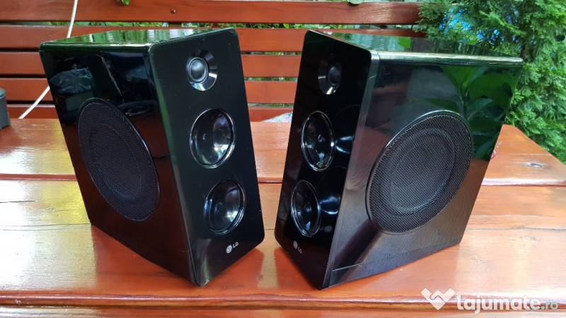

I have the speakers attached ... from LG
Unfortunately i discovered that one front mid is not behaving properly
But the side firing woofers (oriented one against the other) produce a nice bottom end
I like this concept that allows to keep the front baffle very narrow
You could think to something similar keeping the coaxials and add a side woofer. Some DIY is needed.

Even with the very cheap LG i like what i ear ... the sound is much fuller than with common microspeakers.
and these are very very cheap.

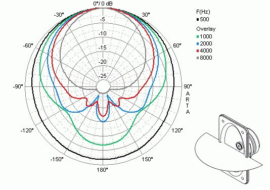

From the polar plot attached it seems that from 500Hz the dispersion is on almost 360 degree
So in my mind is important to get down at least to 500Hz with the front drivers and then fill the bottom with the side firing woofers ?
The woofers can be of the shallow profile type like those used in car installations. And they can be even 10" and eq ...
