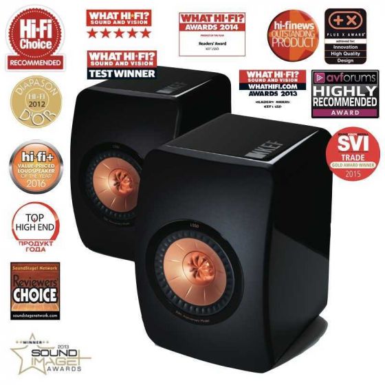

The talk of coaxials is interesting. If you're inclined in that way, I can recommend the KEF HTS3001SE speakers. Use the 4.5" coaxial with a good bass driver, and you'll have a very nice system.
Of course, PA coaxials use compression drivers, and I thought we were avoiding those.

From the first post:
The Kef speakers I mentioned previously fall into those parameters.
I still like compression drivers, though. Keeping the sound off the side walls is really helpful IMO.

... The talk of coaxials is interesting. If you're inclined in that way, I can recommend the KEF HTS3001SE speakers. Use the 4.5" coaxial with a good bass driver, and you'll have a very nice system...
Thanks a lot. I think i have listened to them in an HT set up and they were very good indeed. I will look for them ... i guess they are out of production now ? it was many years ago ...

No problem. Yep, those speakers came out a while ago. You might be able to find something more recent - I just kept an eye on eBay until something useful came up at a price I was happy to pay. The "tangerine" tweeter waveguide is something they've kept with later models, so I decided to try to find a model that included those.

Thanks again. The last generation of Kef coaxials has got rave reviews ... like the cute ls50s
I wonder if they do have that tangerine guide you mention
