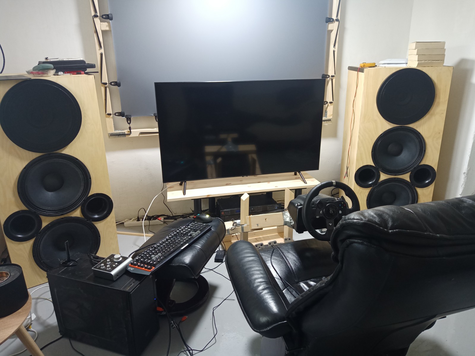

IMO you still don't know what you're missing 😀
See the attached pictures, my PC speakers.

😱IMO you still don't know what you're missing 😀

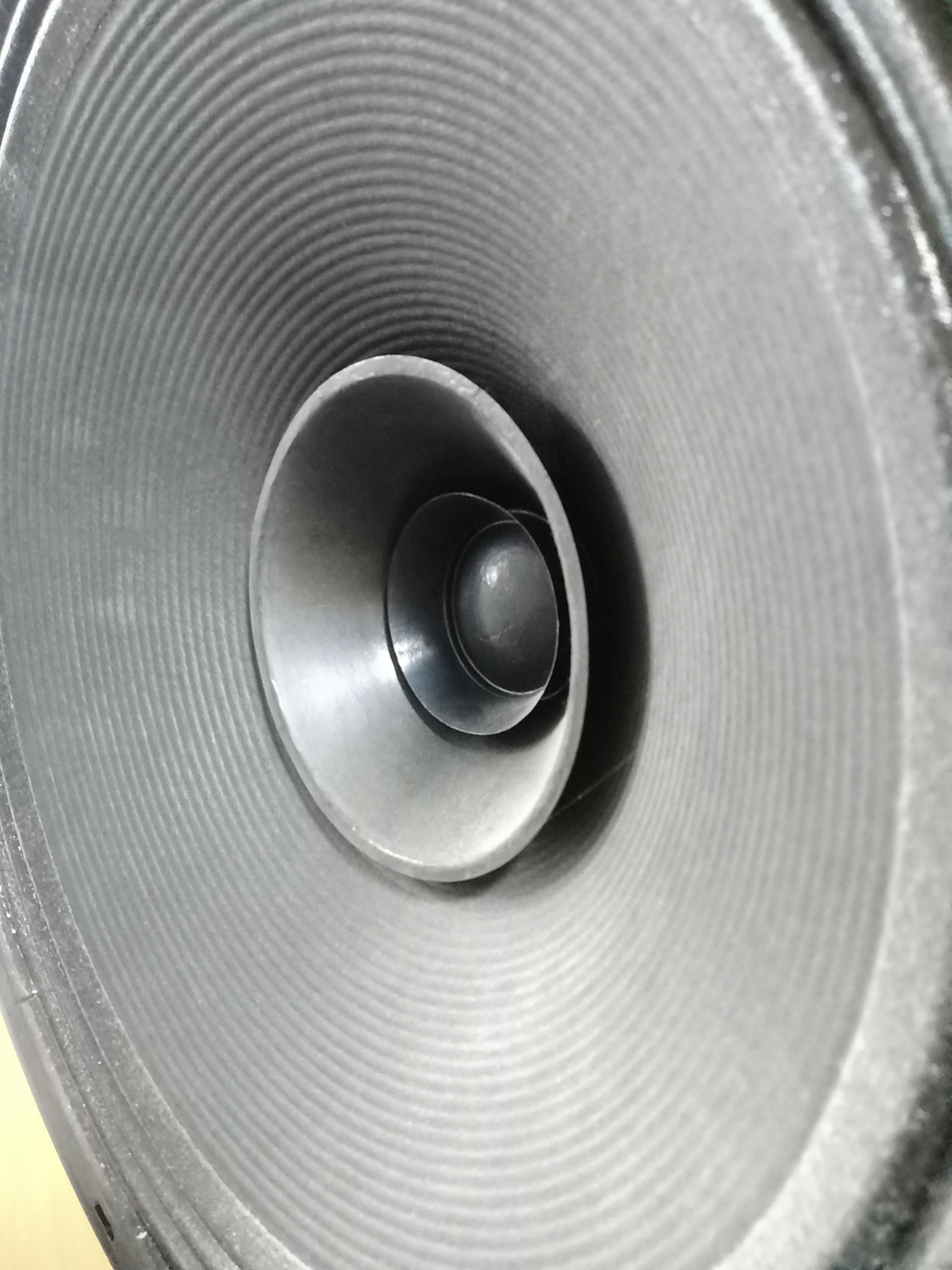

Those pc speakers are 2way. The driver on the top is among the first of the Fane15-300TC.

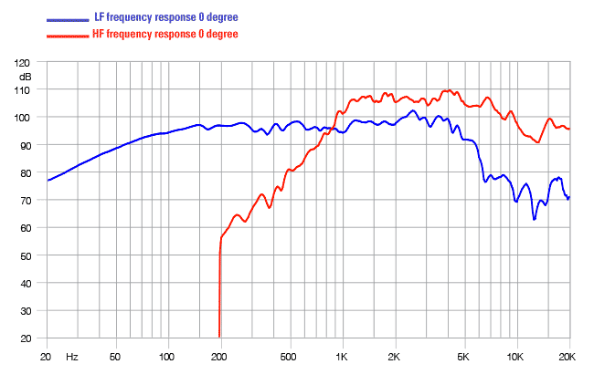

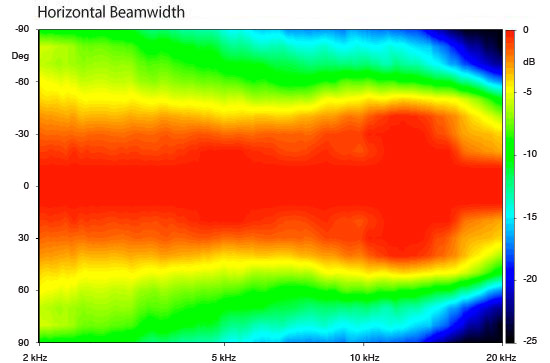

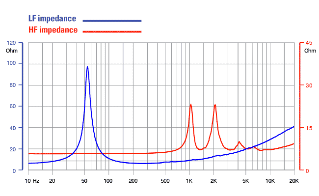

If you want a 12" coax the Faital 12HX230 is one of the absolute best alternatives.
I have ordered the parts for my next living room speakers, a not yet manufactured 8" FR from SB and the Faital 12PR320.
Thanks ! i see now ... a single dual-cone driver

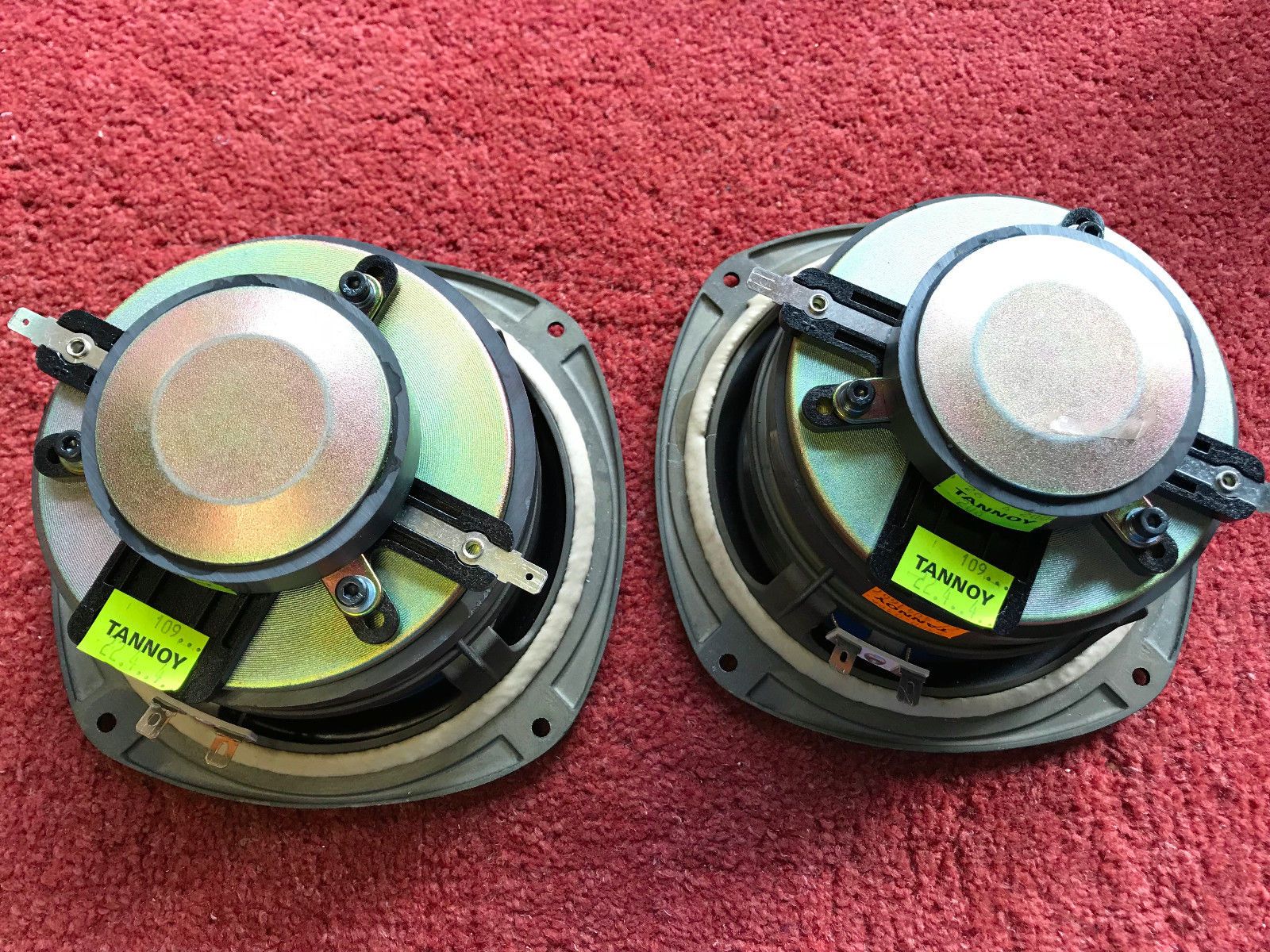

yes ... i like coaxial a lot indeed. I have some small cheap Tannoy drivers ... up to 8" I like their soundI have ordered the parts for my next living room speakers, a not yet manufactured 8" FR from SB and the Faital 12PR320.
But honestly the idea of having just one big biamped and eqed ... that would be nice ... very nice

Thanks ! i see now ... a single dual-cone driver![]()
Close, but no. In fact it is actually a 15" triple cone driver. 😀
See picture.

There is a huge amount of mediocre coaxials, the 12HX230 is an excellent example of what is possible when a company gives it's best effort.
A golden standard.
Mating high quality polymer CD membranes with a 12" that can reach high enough and clean enough to make a proper crossover is not easy. The horn loading of the big driver is usually a limiting factor, and at the same time you frequently run into resonance issues on both the CD and the large driver.

At any rate, have not really looked at the numbers yet, but if the 12hx230 is what you want, could be it can be convinced to go to around 40-45hz reasonably well. What size/dimensions enclosure would you like?
How about a JBL Control 321C/CT 12" coaxial?
Was just looking at its brochure, and suggested it here for no particular reason.
Managing a crossover in the low kHz would not be considered as important as consistent narrow directivity and low diffraction through the treble.why coaxial are not more popular

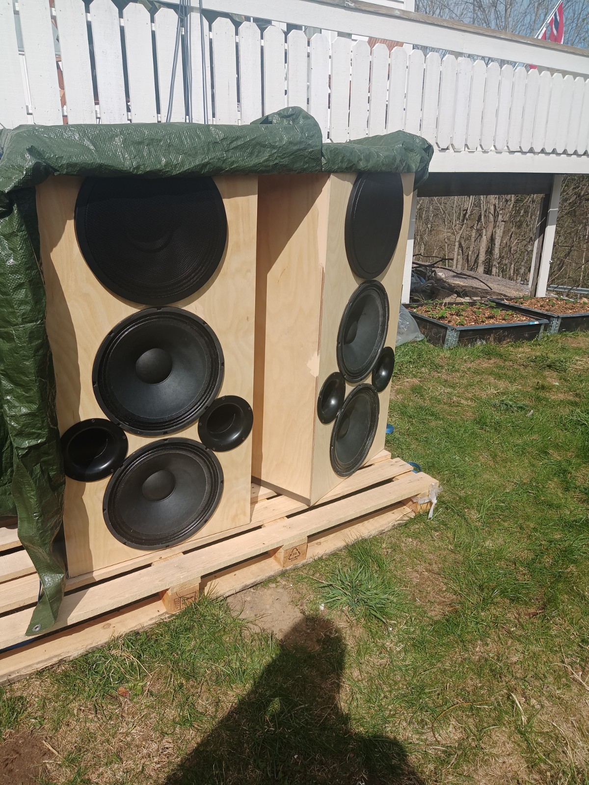

Impressive "PC-speakers" 😀 I think you dont need any tactile transducers under the seat with those.
What are those bottom bass drivers? 🙂
The drivers on the bottom are not in common sale as much as they used to. Special order apparently.
Fane 15-400 (not the LF version!)
SOVEREIGN 15-400
I made the box so if I need/wish to replace the drivers, I can change them out with for instance the Fane PRO 15-600 or several other drivers from other manufacturers.
Yes, very tactile, even at very low volume I feel it, the bass is not excessive by any means, if I am to describe it with two words: "accurate" and "dynamic"
SOVEREIGN 15-400
