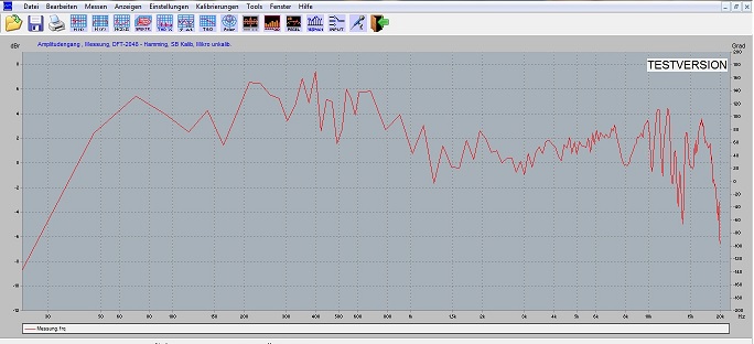

This horn is the one from the 4425 monitor. With a passive crossover quite an effort is needed to tame those peaks. The HF drop OTOH isn't that much of a deal even with a passive crossover because one would need a voltage divider to match level with the woofer. Such a divider can eaily be turned into a shelving filter.

eek, I don't like those peaks (resonances).
Raw data (no smoothing) with LMS are not very pretty. If you think this is bad, wait till you see some dome tweeters. 😱

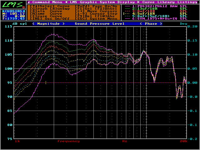

Here's another plot, this time a Pyle PDS382 1" Compression driver with a Pyle PH612. If the hump at 2K is left uncorrected, it will result in the dreaded horn "honk".

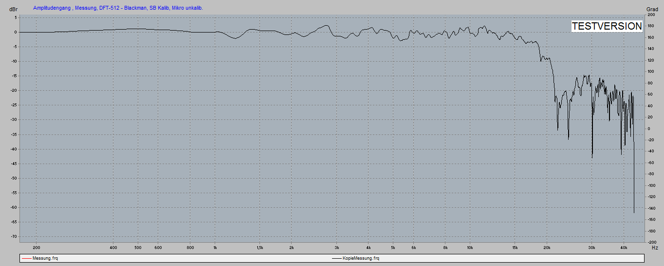

In the meantime I had some other things to do but I nonetheless did some measuring and tweaking. The active crossover topology that I use is asymmetrical with a 2nd order lowpass and 3rd order highpass of Special construction. Although I also use an additional Bessel lowpass on the woofer as delay.
The crossover's properties lie somewhere between a LR2 and a 3rd order Butterworth. I.e. its lobing behaviour is a bit better than BW3 but slightly worse than LR2. It is constant voltage with the acoustic crossover point at -5dB approx. The power Response is slightly worse than the BW3's but better than that of the LR2. Another interesting property is the group delay (or actually Group delay distortion which is lower than that of LR2 and BW3 (below 250us for the 1kHz crossover frequency used here).
I will add a Phase EQ tomorrow and have a look at what we can do about the step response by further reducing the already low group delay distortion).
Here you can see the measured in-room amplitude response.
With the tool used (ADI's Sigma Studio) it would of course be possible to achieve a better linearity but I don't know whether it would make sense.

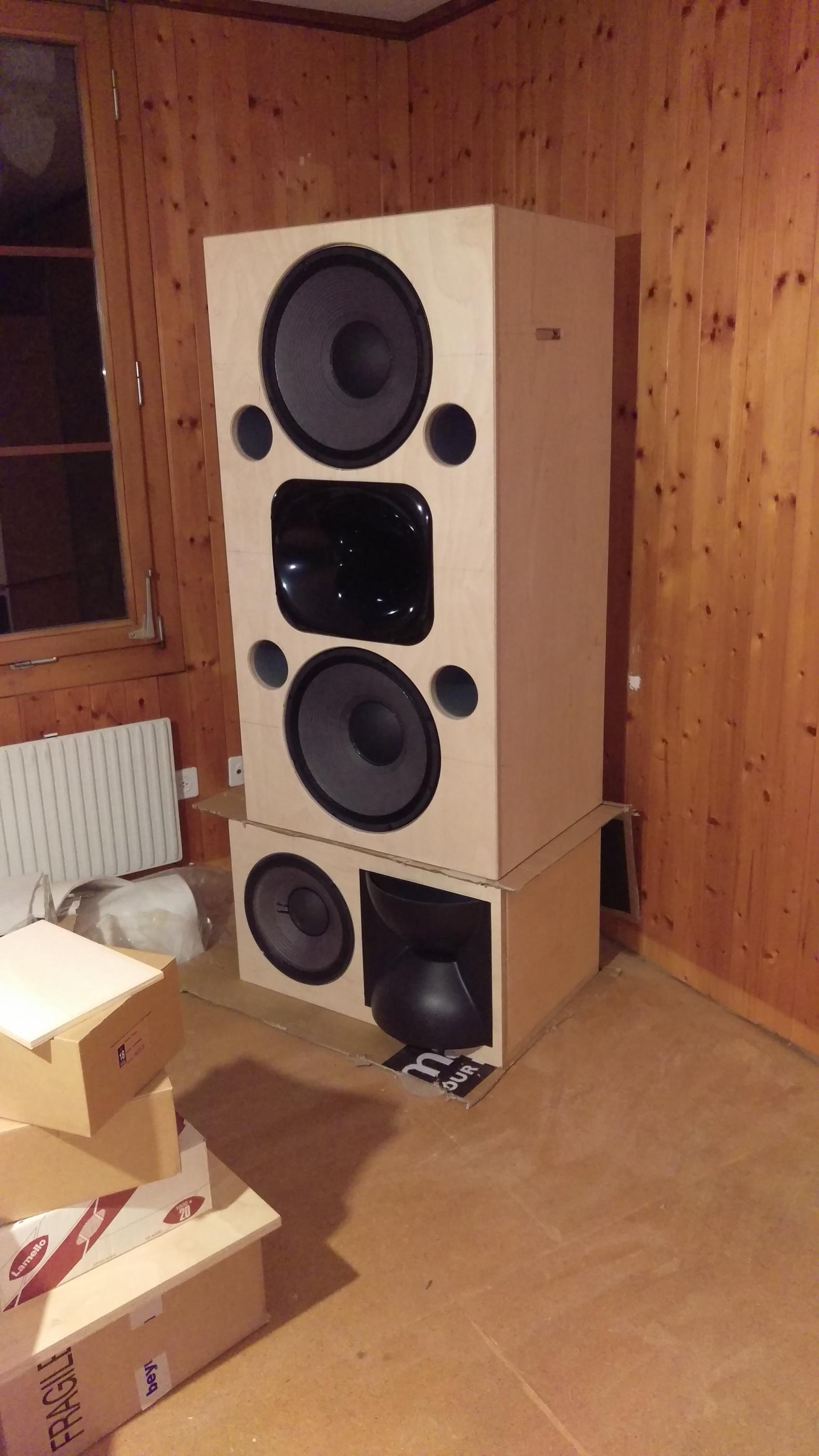

In the meantime I was working on my large MTMs. It took me much longer than expected. It was planned to have them finished about one month ago and being currently building a large three way that was designed many months ago.
But nonetheless here they are, standing in my workshop. Lacking decent stands I just took an older design of mine for that purpse (no fear - it is quite sturdy !). Tonight I will start finetuning the crossover with AD SigmaStudio. They have only been formally tested so far with the headphone output of a small radio and the woofer sections have been tested with a six string bass and a 500 Watt bass amp.

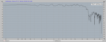

After a bit of playing around with Sigma Studio the response looks like this. I have increased the level of the LF channel a bit according to subjective taste but will do the dropping response thing a little differently later on in order to avoid that downsloping ramp between 500 Hz and 1 kHz. They are generally within +- 3dB from 40 Hz to 18 kHz (apart from the hole at 13 kHz).
I will further fine tune as soon as I can shlepp them outside for measurements with less room influenece.
