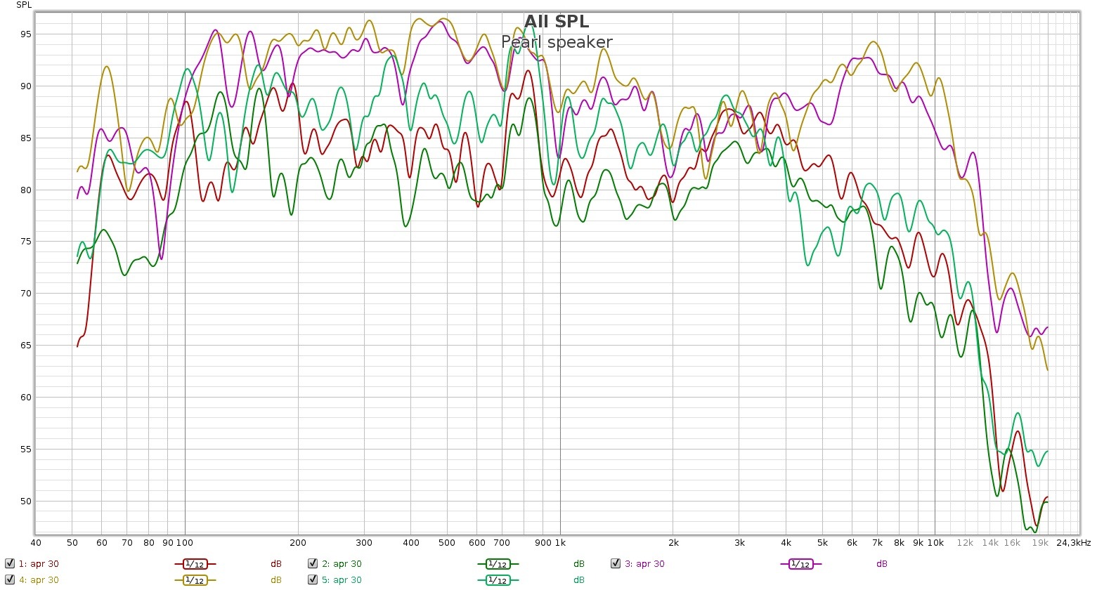

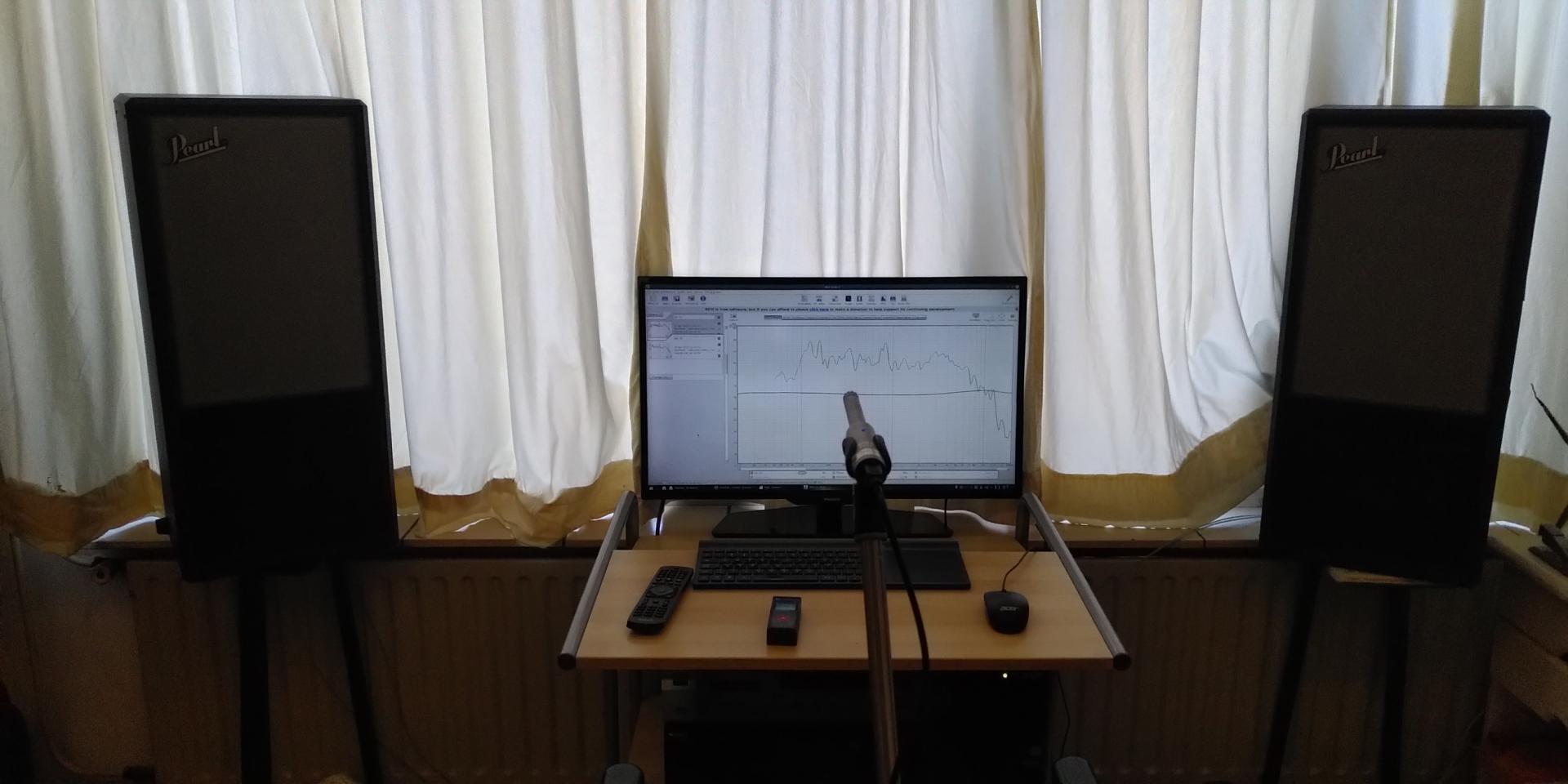

Here we go. After reviewing all REW settings and calibration etc. the initial setup of REW was the culprit. I installed an upgrade of REW first and then took measurements right away, so that mistake resulted in a misleading great looking graph.
Graph explanation: the two upper graphs were taken at 25cm/10" from the tweeter, on tweeter height. The two lower graphs were taken from the listening position, one speaker at a time. The middle green graph was taken in stereo mode from the listening position. At the moment, I don't feel like taking measurements in a better position, it won't matter much.
Conclusion: not very impressive, but I still enjoy the sound of the speakers 🤣 although they are not perfectly placed in front of a glass window.
Lesson learned: when something is too good to be true, it probably isn't (end of story) 😏

In reality it looks like many other 2 way systems
crossed around 3k with 1st order.
Sure my Dads old pioneers with cone tweets didnt
measure much better.
Funny how we can enjoy sound, and rough looking
measurements. Can be ok.
