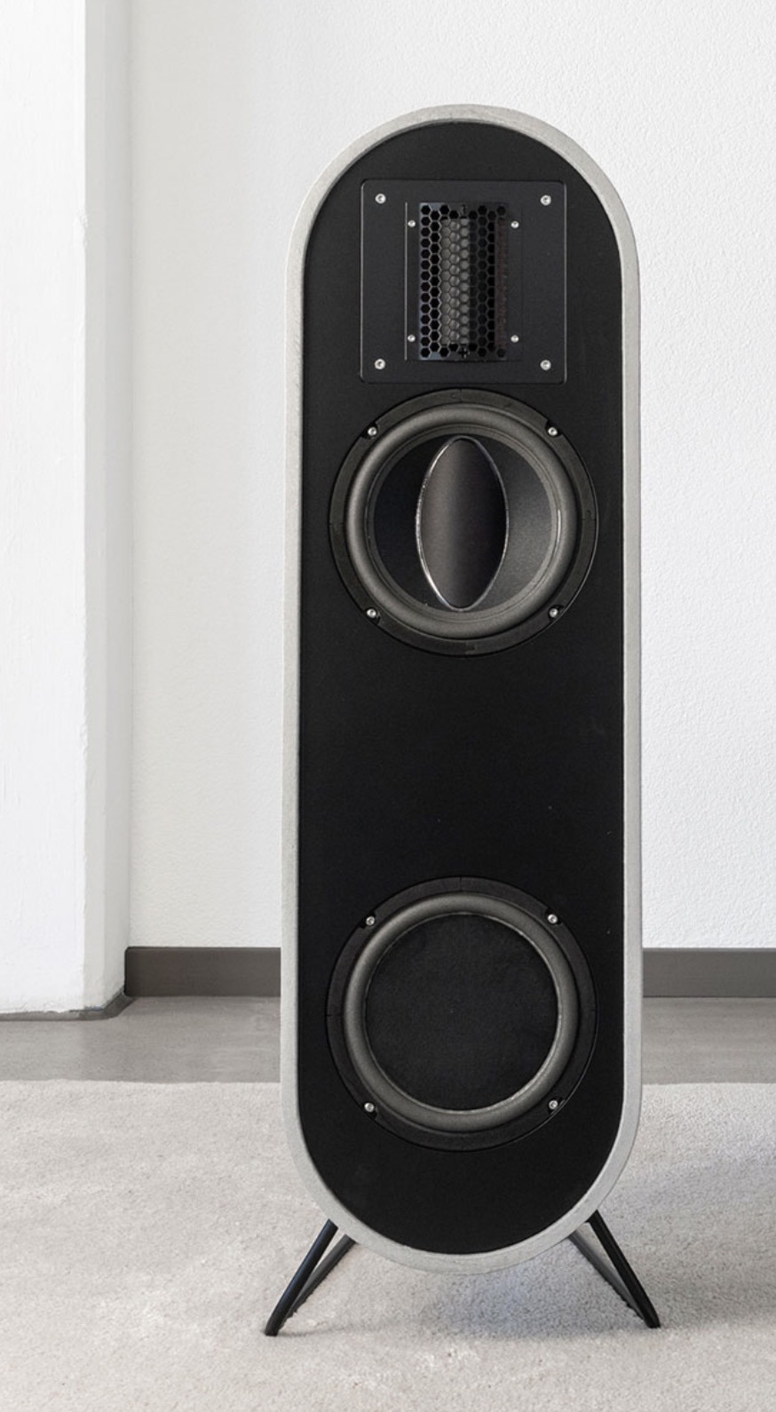

One other more radical solution is to try to reproduce a simpler version of something like this (pic below):
https://minimalissimo.com/articles/loudspeaker-l8-l10
Made of concrete but the oval design appeals to me greatly. And they claim to go down to 25hz. Could be made using the thin ply glue laminate method used in my triangles but would need help choosing drivers.

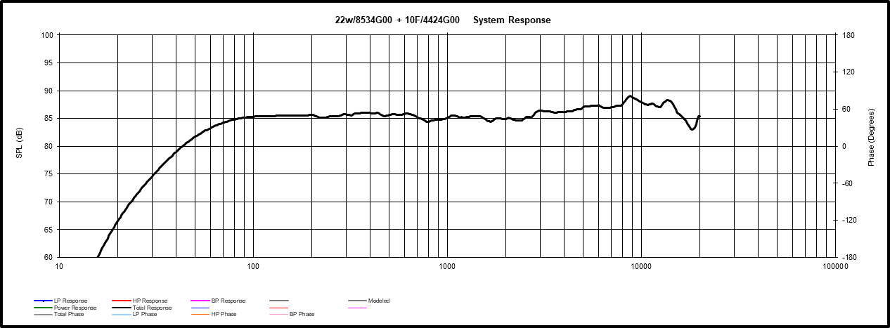

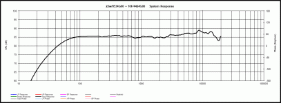

I've forwarded the details to Dave, who is probably still recovering from the palpitations 😉 but they're there. While he's recovering from the horrors :vampire: I took the opportunity of simplifying the filter somewhat as I was able to hit the target LF transfer functions without the Zobel I originally used. This one is a medium / modest sized floorstander however rather than a standmount. One of the latter is in the queue though.

I don't generally design for that type of response unless it's a custom commission; I normally aim for a more neutral balance, so probably not as is / will be. The Scan mid-tweet in question here doesn't really have significant HF peaking beyond a milder rising trend which averages out to a fairly linear presentation once the power response is factored in, so realistically something different would be required.
