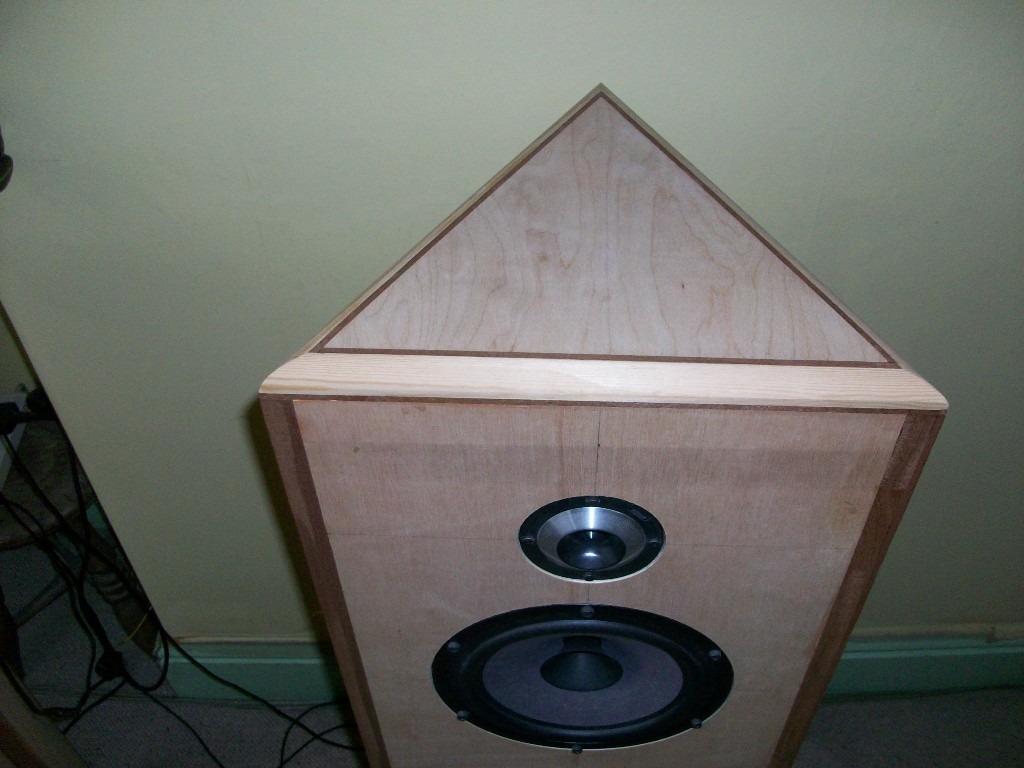

I built this a few years ago and it went down very well at an annual show attended by the audio talk forum here in the uk. I sat on this idea for over 10 years after attending the one and only diyaudio event here in the uk, in 2007. At that show there was a chap showing a triangle plan cabinet with a Jordan speaker which I thought sounded quite splendid.
Anyway, move forward 10+ years and I’m clearing out unused drivers from the shelf and put together this after remembering the diyaudio show and wondering what the triangle plan shape actually brings to the party. I was not disappointed.
I didn’t put the details up on my website as I was winding down all things hifi, but in essence it’s a 43ltr sealed cab with a seas fa22 and fostex ft17 with only a series cap.
If it’s of interest I will post build pictures and details.
