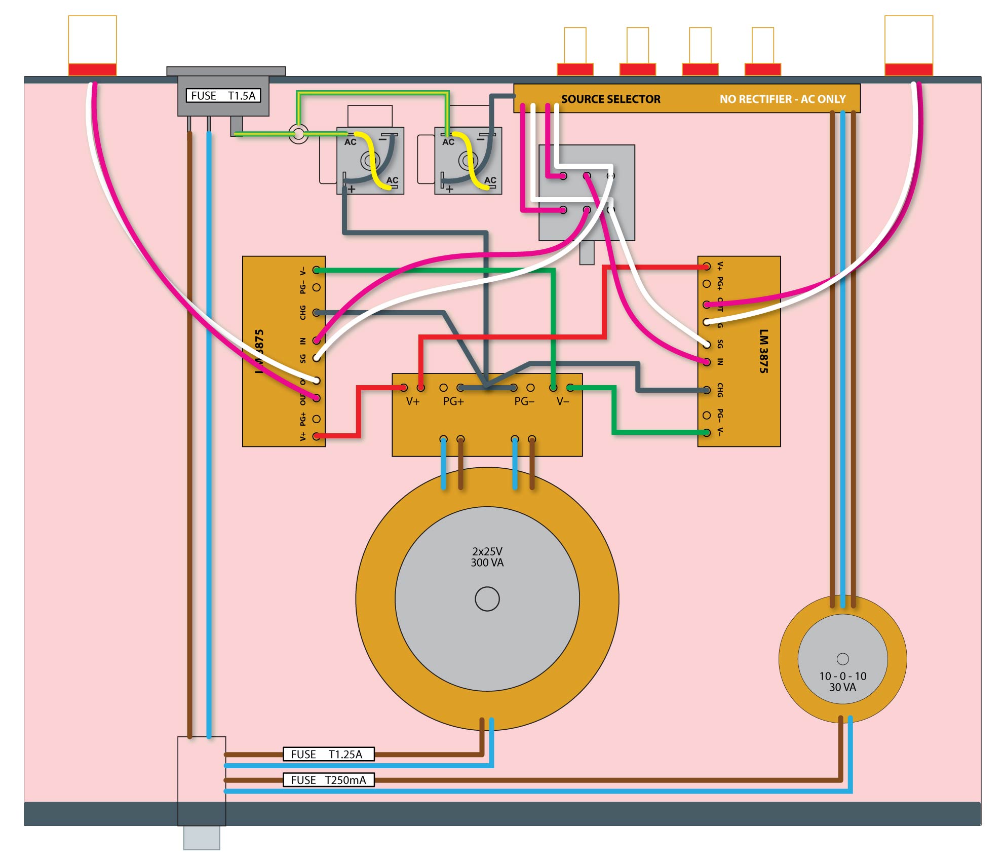

Two transformers in one chassis
Hi Mark, thanks a lot..
A 300VA toroid without a soft start will likely require a T4A fuse to start reliably (3*VA/Vac)
It may start a few dozen, or even a hundred times on a T3.1A
I had two 625VA from the same manufacturer. one started reliably on a T5A fuse, the second blew that size of fuse on almost every start up. It did start on a T6.3A fuse. Then I adopted close rated fusing and used T2.5A fuses for both without nuisance blowing.
