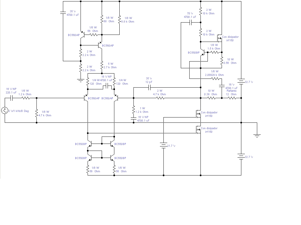

Hi:
Here is my new design of a two stage amplifier with output mosfet run in class A. Output power is 4,8 W into 12 ohms for input of 2 V RMS. Máx Output power is 30 W into 8 ohms. Z input is 5k9 aprox.

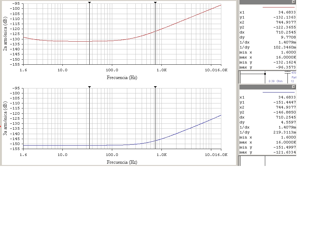

In the attached file are the curves of total distortion vs. frecuency into 6, 8 and 12 ohms and for input of 0,001 V until 5 V RMS.

I didn´t put the cascode voltaje made with one fix resistor + potentiometer + zener + diode in series between negative rail and ground, only for a bit clear schematic.
The power supply is made with 4 transformers: 4 units x 220 V/24 V/240 VA (two for channel). Total of 960 VA for 30 W + 30 W RMS aprox máx in class A.
28200 uF per rail and per channel. Total of 112800 uF.
4 bridges diodes of 15A.
PSRR is around 93,7 dB.
Any sugestion?
Very nice circuit - your output stage is very close to something I am considering to use with tube driver, except I was not (until now) thinking of using the Aleph current source that you have employed. The Aleph is very well thought of, not surprised you find it sounds so good.
What is the purpose of the capacitor between emitters of the LTP input pair ?

That capacitor connected across the emitters forms a low impedance at high frequency and raises the gain of the diff pair. This may get you Lowe distortion, but you will have then probably have to deal with reduced stability margins and possible TIM. I'd leave it out - its always better to trade a bit of distortion for stability in my view.

Bonsai: The capacitor in conjunction with other elements reduces the phase margin, but improves significantly the composition of the distortion. Can be altered as needed.
AndrewT: The cascode at the output reduces the THD to significant levels. At the same time reduces the maximum output excursion. The intention is that the output excursion is sufficiently far from the supply voltage (in normal use) to effectively use the slew rate achieved by the system. Unfortunately, you pay with low efficiency. I use high output impedance instead of the traditional 2, 4, 6 or 8 ohms, because in this same way I get a wider dynamic range. I give an example, for every doubling of output impedance get about 6 dB higher range, using the same interconnect resistance. For example: With 16 ohms achieving a range around 24 dB higher than 2 ohms, changing only the voltage and current relationships!. I designed this amplifier to behave more appropriately in 12 ohms and low levels of distortion achieved mainly in the range of voices.
There is a small error in the first post and it's just that you can achieve a maximum power of about 30 W per channel into 12 ohms instead of 8 ohms as mentioned. In the attachment is all correctly specified. It was only for my trouble.
The idea is to try it and discuss the results.
