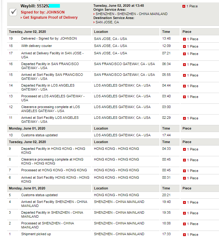

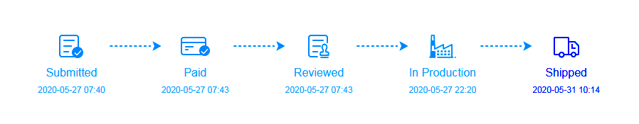

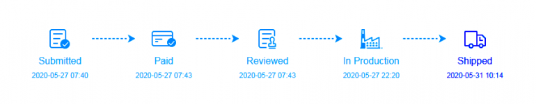

Here is a recent experience I had, buying 4-layer PCBs from the Chinese fab named JLCPCB.
Tues, May 26, 3:40PM California time: Uploaded Gerber files to JLCPCB website
Wed, May 27, 07:40AM Shenzhen time: Received email acknowledgment from JLCPCB {see leftmost icon in Figure 1 below}
Sun, June 01, 10:14AM Shenzhen time: Fabrication complete. Finished PCBs boxed & placed on JLC's loading dock {see rightmost icon in Figure 1}
Sun, June 01, 5:33PM Shenzhen time: DHL picks up shipping box from fab {see BOTTOMmost line in Figure 2}
Tues, June 02, 12:31AM Hong Kong time: shipping box arrives at DHL sort facility in Hong Kong {see line item 6 of Figure 2}
Tues, June 02, 02:29AM California time: shipping box arrives at DHL sort facility in Los Angeles {see line item 11 of Figure 2}
Tues, June 02, 1:48PM California time: DHL rings my doorbell, obtains my signature, and hands me my box of thirty 4-layer PCBs. {see line item 19 of Figure 2}
That's right. In 6 days + 23 hours, JLCPCB built thirty 4-layer PCBs, shipped them by DHL, and I received them at the front door of my home.
An hour less than 7 calendar days! You'll notice that these guys work hard even on the weekends. Amazing.

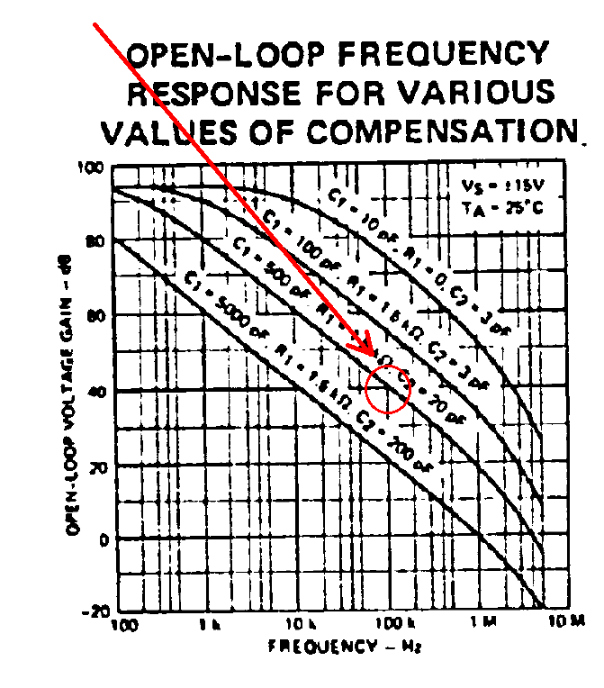

If humans are NOT capable to PERCIEVE ultrasound, why does an amplifier need to have a bandwidth extending into MHz?! Provided the bandwidth is enough for high frequencies to be properly reproduced, there is no necessity.
For the same reason why audio op-amps always have gain-bandwidth products in the megahertz range. For example, suppose you want to make a feedback amplifier that has a simple single dominant pole compensation and (in order to keep the distortion for high audio frequencies low) a loop gain of 100 at 20 kHz. Do the math and you will find that the bandwidth is (at least) 2 MHz. Of course you can restrict the bandwidth with passive filters at the inputs and outputs, and doing so will reduce the chance of receiving broadcasts you didn't want to receive, but the basic amplifier has a 2 MHz bandwidth.
I'd say they are smaller, so they are worse aerials/antennas, so you get less interference problems.
Definitely. Ground planes are more effective with smt packages, also.
It's not just the components, it's how they interact with the PCB traces and layout in general. Small SMD parts have some funky behaviour at high frequencies (like 4G and WiFi frequencies which are abundant these days) - resistors can become inductive and capacitors have low impedance, it can have unexpected interactions with a circuit when the parts don't work as expected. Assume with something like an audio amp that will result in more output noise - you can get that by placing your mobile next to some equipment.
... audio op-amps always have gain-bandwidth products in the megahertz range.
The integrated circuit opamp called uA741 (released 1969) has a gain bandwidth product of 1.0 MHz. It is internally compensated to be stable at a gain of 0dB (1X). The integrated circuit opamp called uA709 (released 1965) has a gain bandwidth product of 10.0 MHz at a gain of 40dB. It is externally compensated. See red circle below.
