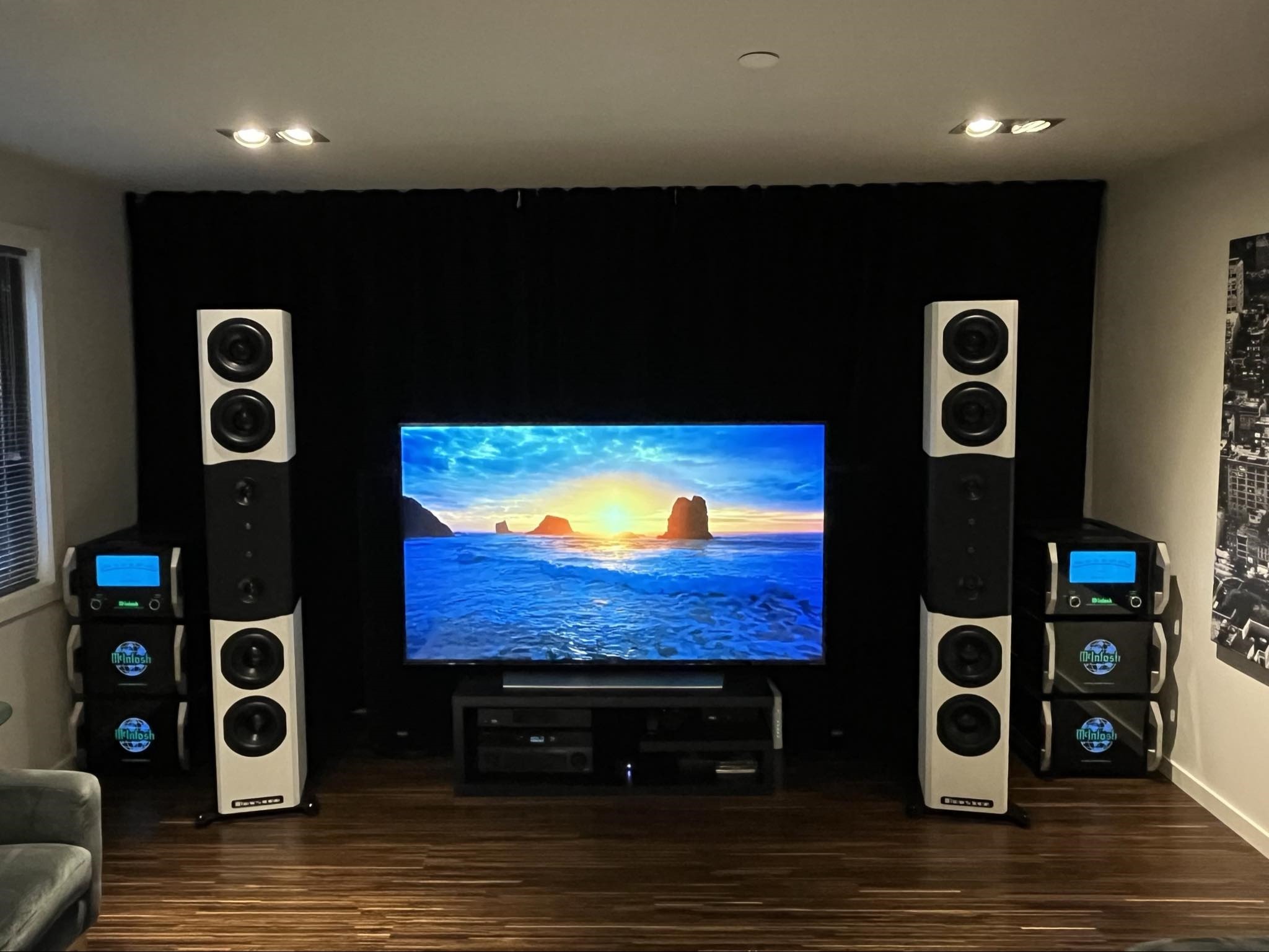

My Norwegian hifi friend is very happy whit hes new Bryston T10 speakers, and he had before big Usher,Focal 3, Sonus faber, Ultima Salon 2, PS Audio FR30 and 15 more potent speakers.
so apparently the concept works

It looks like a typical wooden house in sweden . On the left the window has nearly no depth , to the right a flat wall with some kind of poster on it , so asymmetrical side wall conditions . Speakers much too close to the side walls , speakers have no lateral directivity control . Just a thin curtain behind the speakers . To the left close to the window a sofa , another asymmetric object . And no carpet on the floor plus a much to much listening distance!
But magical McIntosh gear , sent by heaven above into this little cabin in the woods 🙂
Praise the lord all day long and you will be forgiven!
Jesus! We must be the chosen few 🙂
Its a Norwegian house 👍It looks like a typical wooden house in sweden . On the left the window has nearly no depth , to the right a flat wall with some kind of poster on it , so asymmetrical side wall conditions . Speakers much too close to the side walls , speakers have no lateral directivity control . Just a thin curtain behind the speakers . To the left close to the window a sofa , another asymmetric object . And no carpet on the floor plus a much to much listening distance!
He take away carpets etc for this photo!
And i promisse you, hes real picky about sound.
Plays Yello for hole the neighborhood 😆

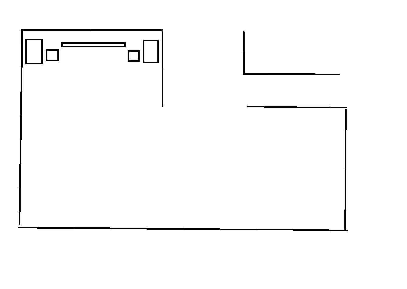

Hes room is a big L
Center to center makes it rather pointless.
2" drivers plus the mounting frame
makes it same or worse than a 6.5"
might as well just use a aluminum
reference 5"
dome mid
allows a smaller tweeter/ higher crossover point.
be taking full advantage of that.
MTM being a udder waste of time.
Dual tweets/ dual mids in some photos shown.
Why? lol
Even at high spl
you will exceed the thermal rating
before linear excursion gets touched.
Because = highpass filter
the mid domes are so small.
Usually run into phase issues up top
for crossover design.
likely only reason to slightly setback
a tweeter is to fight against the crossover
design time.
Very very tight margin for phase up top.
and 4th order would get dream like vertical.
MTM just pure garbage
Domes sound marvelous.
Just one, and a small small tweet.
Untouchable vertical.
Sitting / standing...you know the actual listening positions
that get ignored
Be easier to fight with a ribbon / planar mid
those sound darn darn good. accurate
if vertical is gonna suffer
