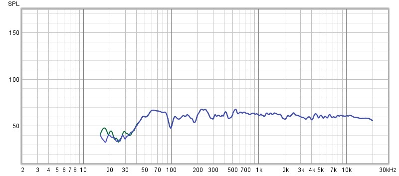

Two chamber speaker cabinet with the drivers in a sealed chamber.
Before I did it I ran my first ever rew sweep with the mic I had for Christmas. I was in my sitting position approx 2 metres away. Can the double bass reflex be seen in the measurements?

Well, i've done a repair job and i'll keep an eye on it to make sure it doesn't get worse. I didn't want to put too thick a layer over it so i'm not sure whether it will hold. While i had the driver out i had a look at the design. rather than i port it was multiple 1-2mm slits spaced apart about 20mm. They seem well made with sheep's wool stuffing, a decent gauge wire and plywood sides then mdf front and back. The port in the bottom chamber is both wider and longer than i've seen before.
I believe this design can be classified as a variant of DCR, but there is a difference in that the partition acts as a mechanical broad banded (non resonant) LPF and coupled with the vented cavity forms a bandpass filter function without the gain of a traditional bandpass design.
DCRs have three peaks in their impedance curve. The partition may be suppressing the third resonance but still allowing the vent to have a wider output FR with more dampened upper bass. Thats at least my theory but without measurments still a speculation.
