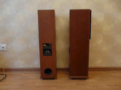

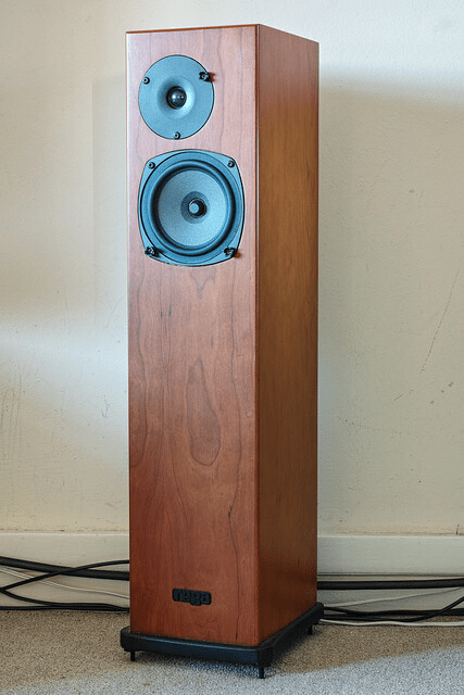

Well, i've done a repair job and i'll keep an eye on it to make sure it doesn't get worse. I didn't want to put too thick a layer over it so i'm not sure whether it will hold. While i had the driver out i had a look at the design. rather than i port it was multiple 1-2mm slits spaced apart about 20mm. They seem well made with sheep's wool stuffing, a decent gauge wire and plywood sides then mdf front and back. The port in the bottom chamber is both wider and longer than i've seen before.

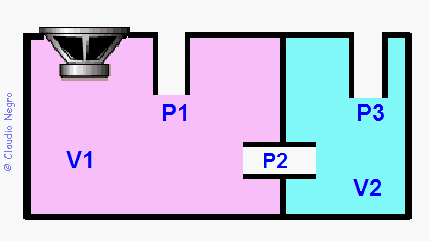

So, it is an "acoustic filter/bass reflex" design as I described.
Jings, crivvens and help ma boab, I got something right for a change! 😎
I believe this design can be classified as a variant of DCR, but there is a difference in that the partition acts as a mechanical broad banded (non resonant) LPF and coupled with the vented cavity forms a bandpass filter function without the gain of a traditional bandpass design.
DCRs have three peaks in their impedance curve. The partition may be suppressing the third resonance but still allowing the vent to have a wider output FR with more dampened upper bass. Thats at least my theory but without measurments still a speculation.

- Two chamber speaker cabinet with the drivers in a sealed chamber.
