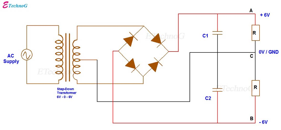

No, you need two isolated secondaries for that.
Use this circuit instead (different voltages, of course).
You may have to rework your existing board somewhat. If it hasn't been made yet, I would redesign it.
