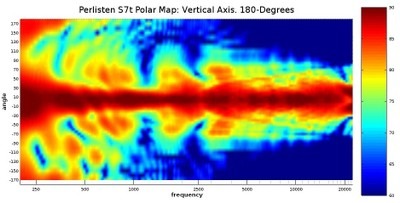

Here another example of using multiple drivers to achieve higher sensitivity (92dB/2.83V 4 ohm stable), in room response to 20Hz, in a cabinet ~100L. And vertical directivity control:
It uses four 7” midwoofers:
Reference:
https://www.audioholics.com/tower-speaker-reviews/perlisten-s7t/#toc-h2-3

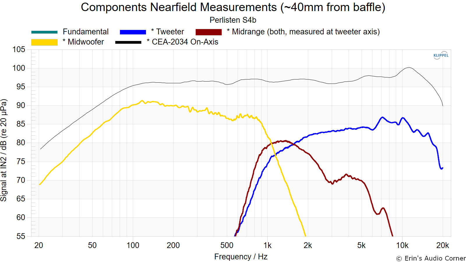

Here’s how the WWtTtWW array is done:
Reference:
https://www.erinsaudiocorner.com/loudspeakers/perlisten_s4b/

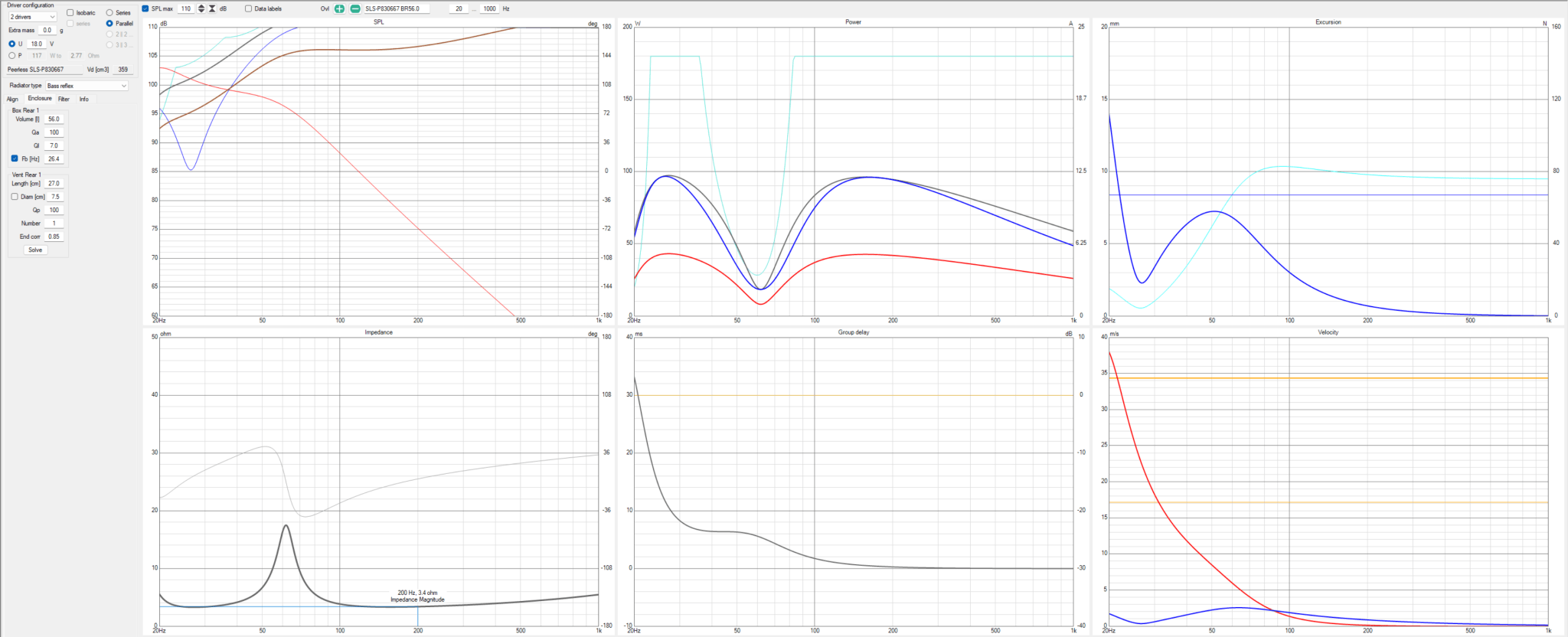

But if one is going to insist on passive, here's another supporting example, using the same woofer suggested, but in a BR enclosure- 2 cu ft for a single 10"-
Observe the basic bass sensitivity- ~85dB/2.83V/m @ 100Hz. Note that F3/F6/F10 are the 2pi stats, see the cursor for the anechoic F10.
If we wind up the volts to exploit the maximum the excursion AND power handling, here's the maximum SPL and group delay and air velocity through the vent:

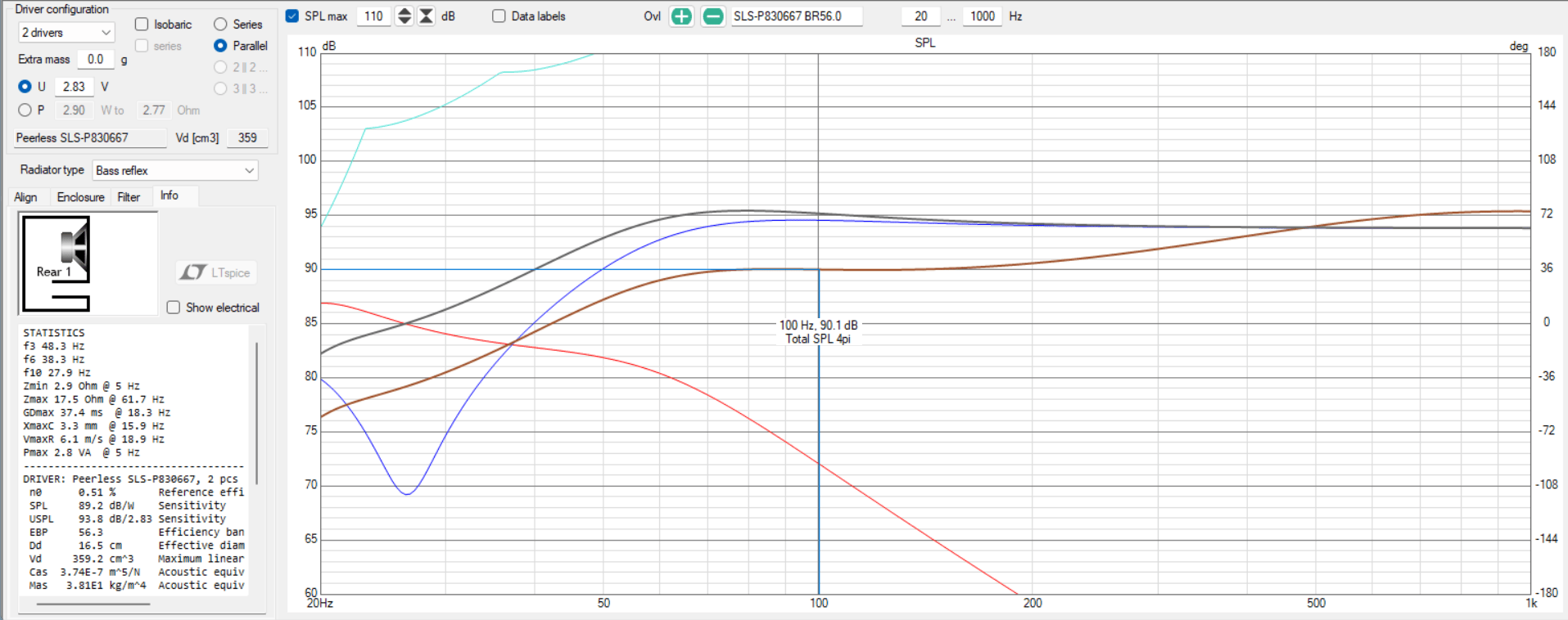

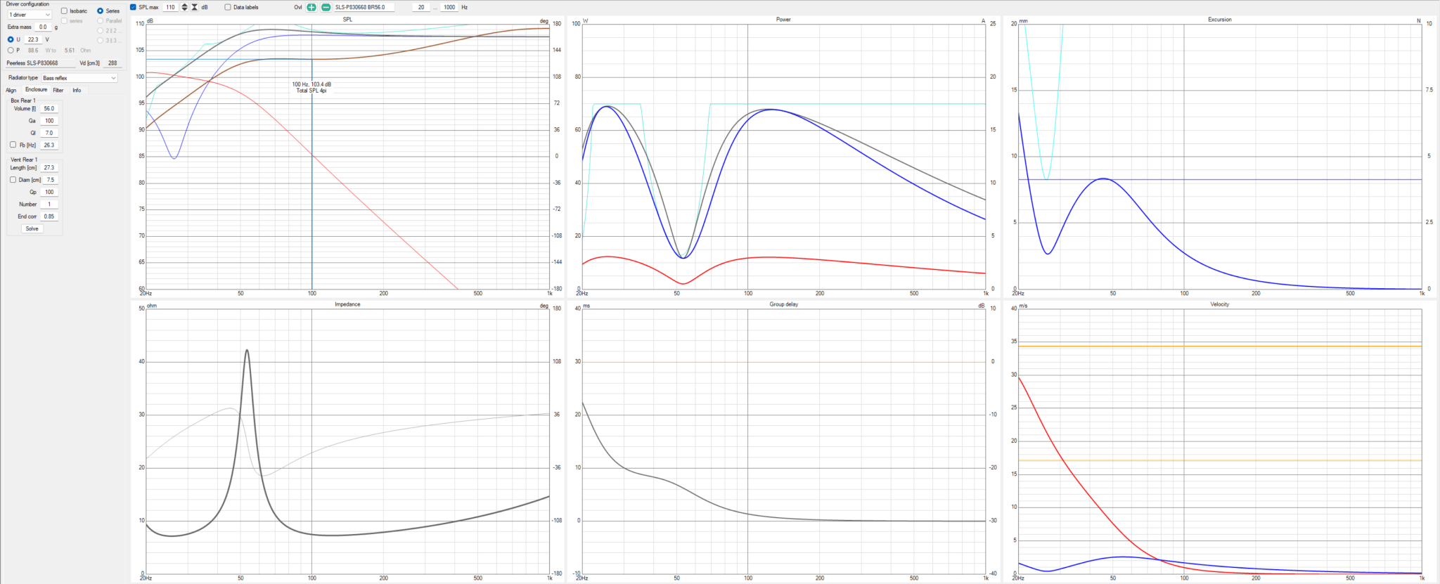

Now, let's compare and contrast to a pair of 8" from the same family- the 830667. Same sized enclosure. Mild change to the vent tuning (see next graph) but note the sensitivity difference- almost 5dB!
Now doesn't the impedance drop too low? Still within 4 ohm load (as expected- see cursor).
And what about the maximum SPL- an extra 3dB!
So 5dB high voltage sensitivity and 3dB higher maximum SPL in the same sized cabinet.
What's the catch?
Sorry about your wallet.

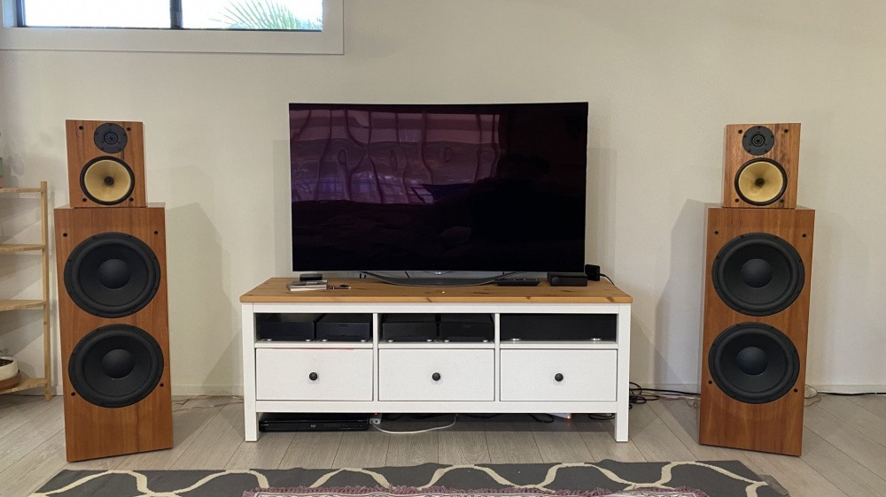

I have some experience with pairs of the Dayton RS225-8 in the Statements II
You've built the Halcyons and liked it?
It makes it easy to recommend: Anthology II

Is that midrange driver a B&W driver and where did you get it?
In my old speaker configuration, I have the similar Focal 7K2 driver..
